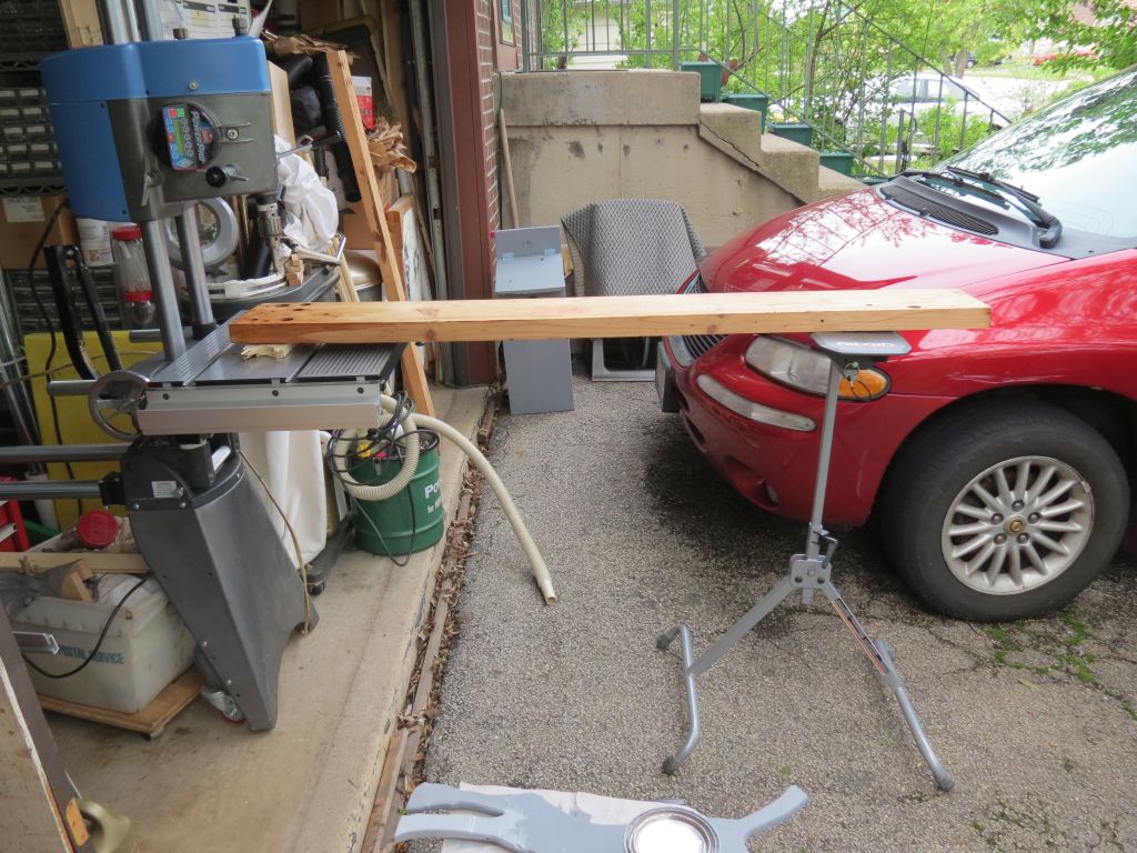

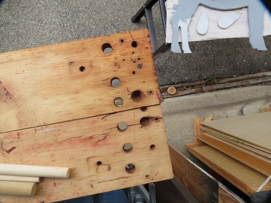

This picture give a good idea of what things look like now.

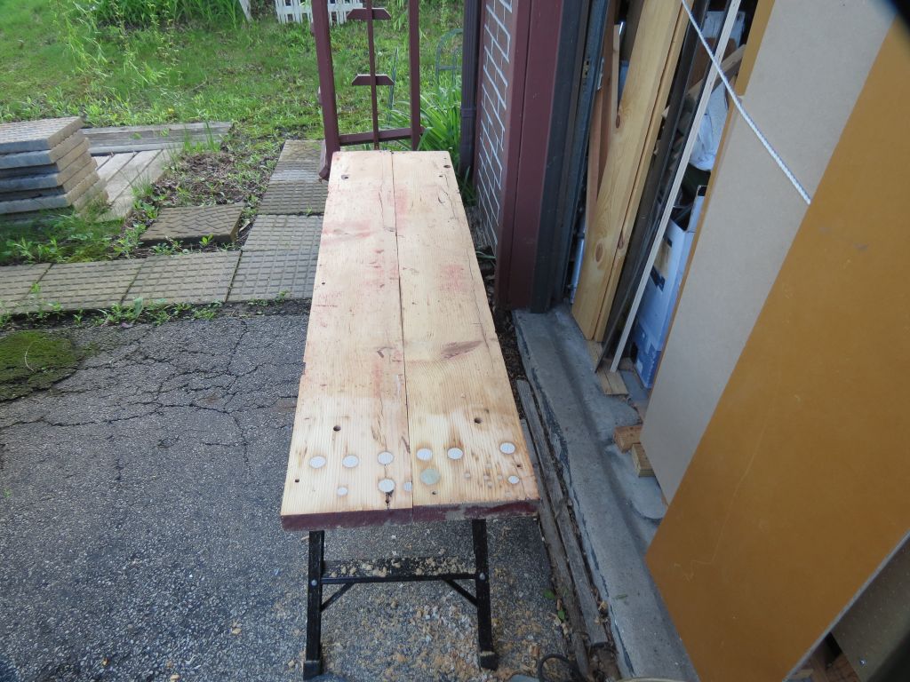

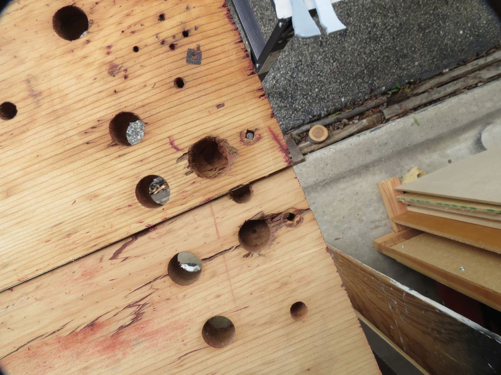

A close up of the holes shows that some of them will take extra work.

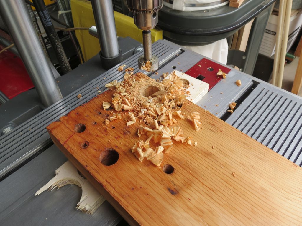

Some of the holes needed redrilling or cleaning up so I set up to do that.
Some of the holes took more drilling then others but there was no problem drilling them. Look how nice the chips are, just like they should be!

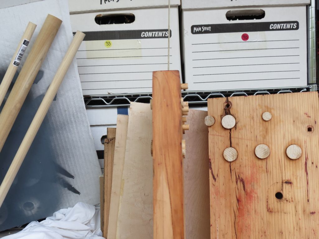

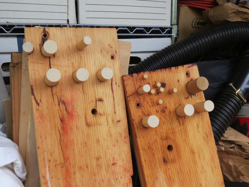

This next picture shows the hole that that are going to be filled.
Tightbond glue and a rubber hammer and in they went. I cut them longer then needed.
I will wait for the glue to dry then cut them flush. Here you can see how much extra I left.

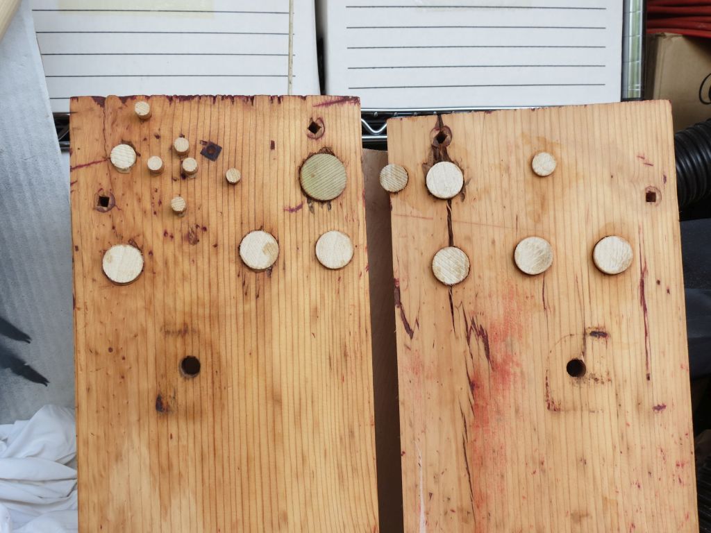

Had a little time left at the end of the day to do a little more on this project.

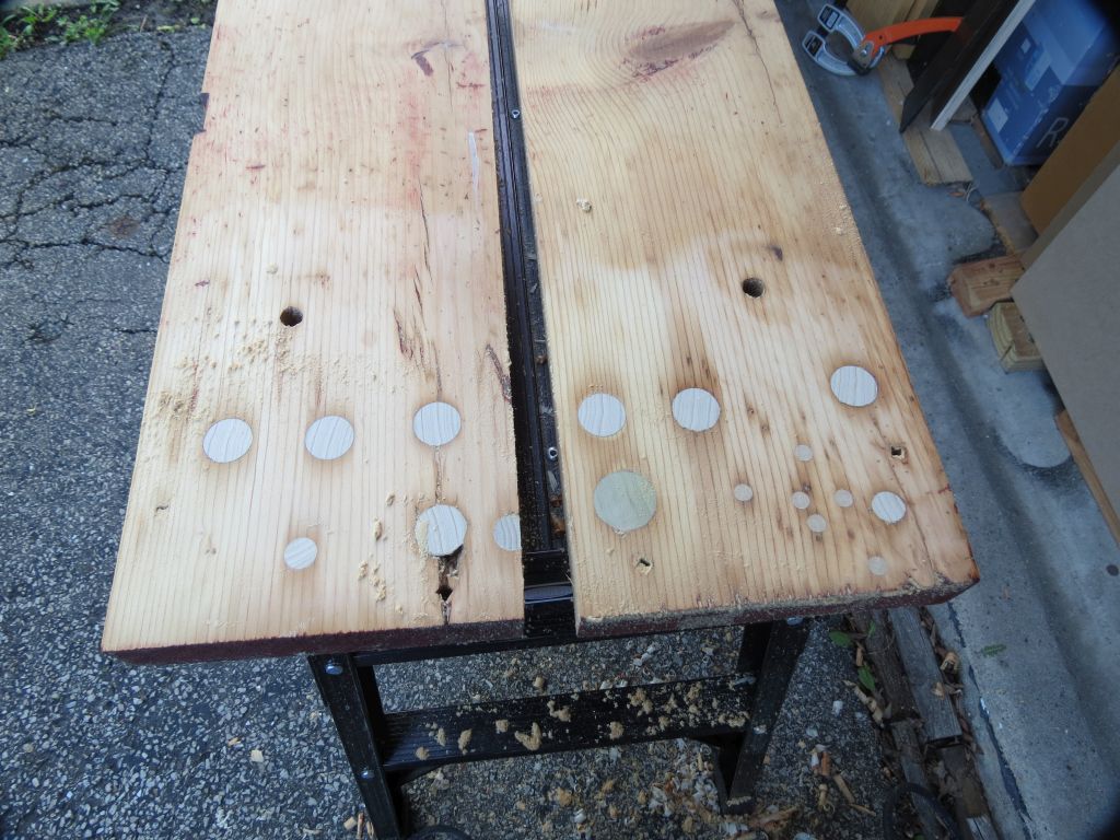

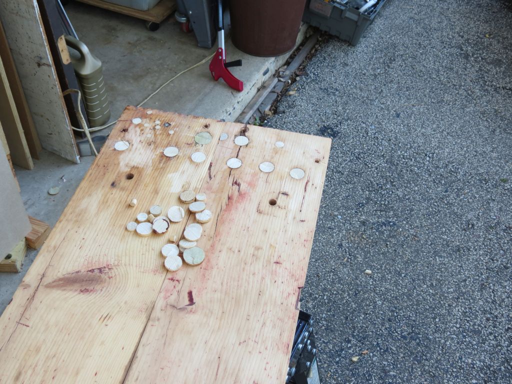

Used my handy no-set saw and cut the dowels down:
Finished with some sanding:
I'm still not thrilled with the look.

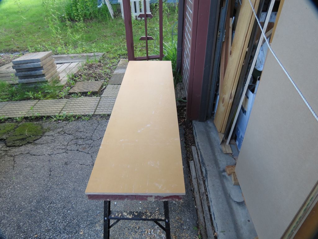

My next thought was to use this MDO (1/2") and very close to the size I need as a top. I would retain the lumber but just cover it up. It will be a bit more work as I will then have to wrap the edge but that isn't too big a deal..... the worst part will be cutting it for the leg braces I think.
Not a 100% sure yet.
