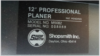

I had a pulley that was cross threaded and eventually the pulley gave out. Thankfully, the metal of the pulley is softer than the rod that is part of the cutterhead. So I think I just need to replace the pulley.

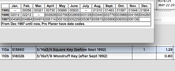

I'm trying to determine age of the unit, so I called help at Shopsmith. She seemed to have the same information that we all have available. The last date code on the "help my identify the age of my planer is 006139. It appears that Shopsmith sold between 1800-2200 unit per year. My serial number of 008088 is definitely after the cutoff for a date code, but it still has a serial number.
The planer has the square key in the pulley and not the woodruff key that would date it after September 1992. It has the crank handle (not the round one) and was likely updated to have the metal infeed roller and better dust collection. I'm not sure if the pulley upgrade was in place at this time, but it appears to have a 5" pulley on the motor and 3" on the cutter head.
Did Shopsmith Perhaps put in a big order for serial number stickers and continue to use serial numbers after the cutoff for date codes? Based on the 2000 units per year is it safe to assume this planner was made sometime in 1988-89? Any help you can give me would be appreciated. I'll try to attached pictures of the serial ticket, date code list and key options.

Just wanted to double-check the age of the machine and make sure I'm correct so when I buy parts, I'm buying the correct items. Figured that maybe someone has a planner out there that they may have purchased during the date code period, but it still has a serial number like my machine.

If you really want to know, I suggest that you ask someone in Customer Service. Your serial number is almost 2000 units after they supposedly discontinued serial numbers. We, here on the forum, can give you nothing more than conjecture. Now some of it may be provided as though it is factual but I suggest you ask someone who knows.
The serial number on that chart, BTW, is the starting serial number for that time period. Given that, it might have been built in Nov 1987.

Don't have a shopsmith planner but I do know that shopsmith sometime does some odd numbering so how about parcing it as /08/88 or perhaps aug 1988??
Anyway you know that it is most likely from pre-1992 due to having the square key and that is the most important thing in ordering replacement parts.
I would be very sceptically of assigning number of units to serial numbers given the way shopsmith operates.

I think the serial numbers are shared between the M5980s (hand crank feed) and M5990s (DC motor feed), but someone correct me if that assumption is incorrect. If it is correct, then my planer was made in Aug of 1983. I guess that means my planer was built in the first year of production. Link to planer FAQ page with serial numbers:
http://www.shopsmith.com/ownersite/faq/planer.htm
The pulley wheel upgrade installation sheet that I did get with the old pulley wheels has a printed date of 6/85. Which is a few months after the Pro Planer was introduced to the Shop Smith product line according to the numbers lettrek posted at the top of this thread.
