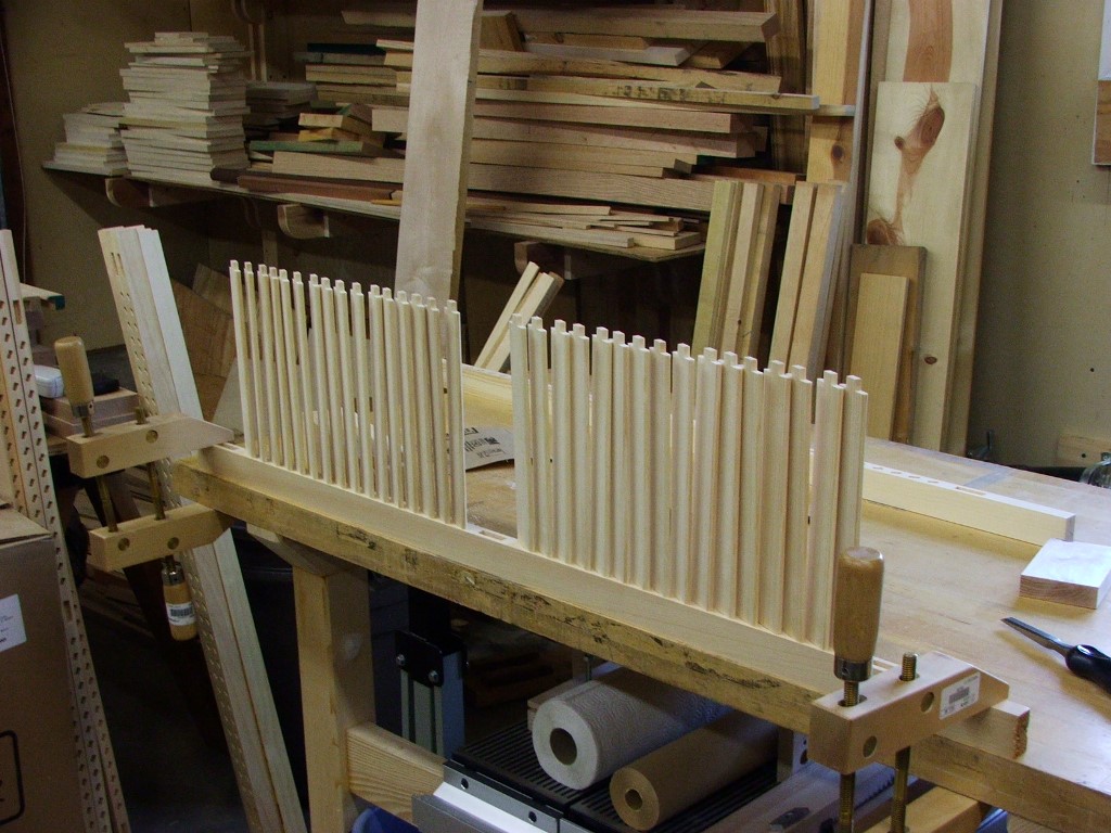

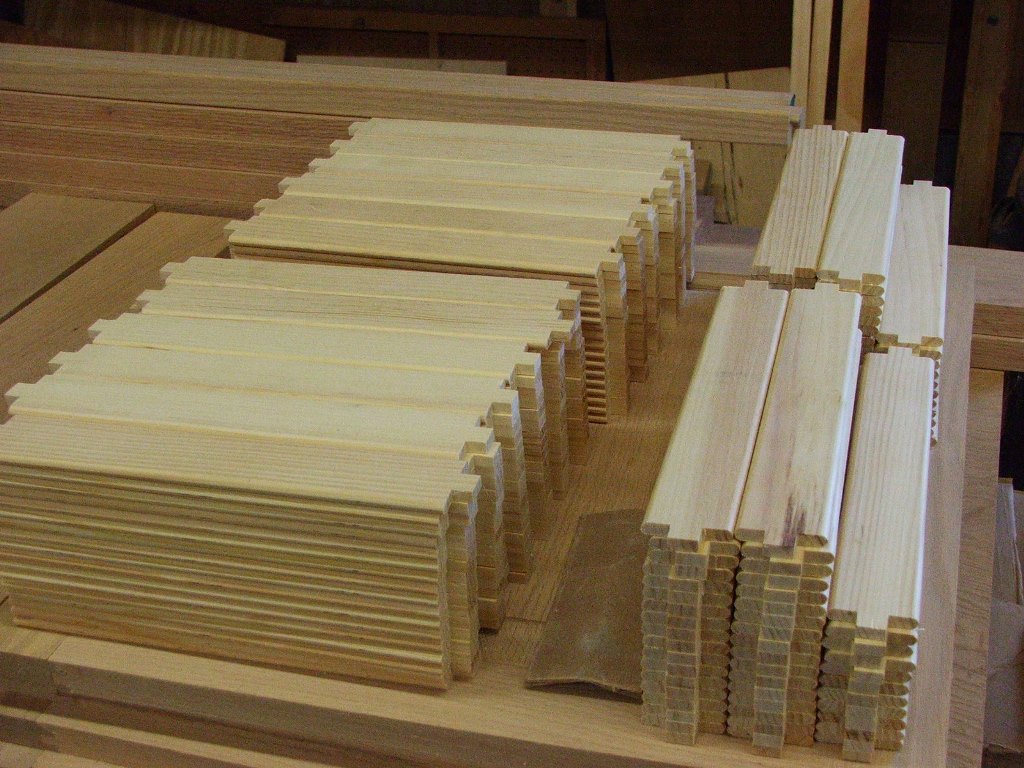

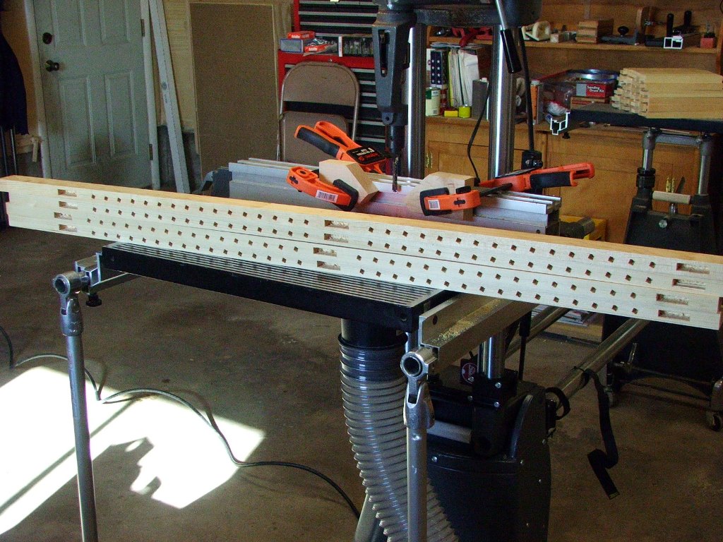

As we all know hollow chisel mortising has been around for a long time and is still viable today. I think the biggest issue is to have sharp chisels just like bench planes or regular chisels. Then there is the old table creep issue. I wonder if that is a hold over from the 500 days before the telescoping legs. (I know, Dusty, you don't trust the telescoping legs but they really do work.)

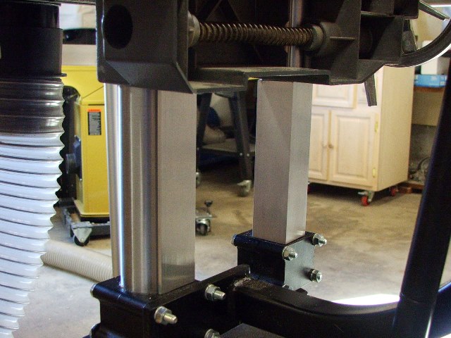

I eliminated any table creep with a couple pieces of aluminum angle iron. That and the telescoping legs and the table is rock solid.

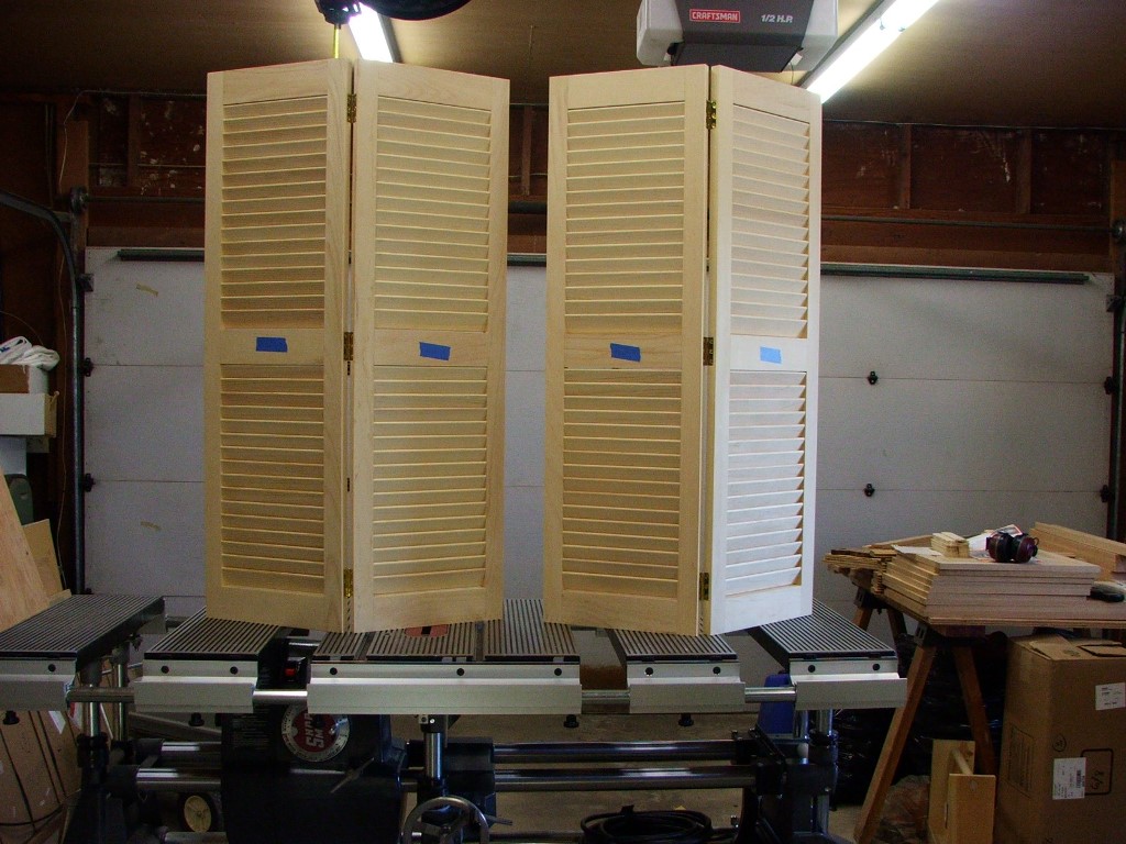

A few years ago I made a set of shutters for a friend at work. He had two 4' X 4' windows in his rec room that he wanted shutters on the inside. Each window had four individual 1' X 4' shutters in a bi-fold configuration. Each panel had 32 louvers. The tenons on the louvers were 1/2" X 1/4". I had to make 256 louvers plus a bunch of spares. The stiles of the panels required two cuts with the 1/4" hollow chisel mortising bit for each tenon. That was 1024 cuts plus the ones for the rails.
The bottom line is the SS never missed a beat.

Pine looks easy(still fun assembling I bet).
Tell us about the angle 'iron'.

Yes it was clear pine but I have done it in Oak and hard Maple. Again, it is all about sharp tools and in this case it is very important. You can't stick a butter knife in even a piece of pine.JPG wrote:Pine looks easy(still fun assembling I bet).

What do you want to know about the angle iron. It is just two pieces of 1 1/2" aluminum angle that sit around the way tubes between the bottom of the table carriage and the end casting or in my case the lift assist bracket. See the first picture in my previous post. They are a positive support for the table carriage. You wouldn't even have to tighten the carriage lock.

Thank You. That explains it = angles support inner side, poles support outer side.jsburger wrote:Yes it was clear pine but I have done it in Oak and hard Maple. Again, it is all about sharp tools and in this case it is very important. You can't stick a butter knife in even a piece of pine.JPG wrote:Pine looks easy(still fun assembling I bet).

Yes they are 'visible' but not 'noticeable'. I did look for them 'there' and did not see them b4 asking.
The key is sharp. Did I mention sharp. They do not come from the mother ship sharp. I tried without sharpening. NOT recommended. FWIW a single pole was/is(?) available from the MS.
I have been considering making some(4) louvered cabinet doors. You have provided incentive to get r done! Not possible prior to band saw/planer acquisition. Thanks.

Beautiful shutters!
