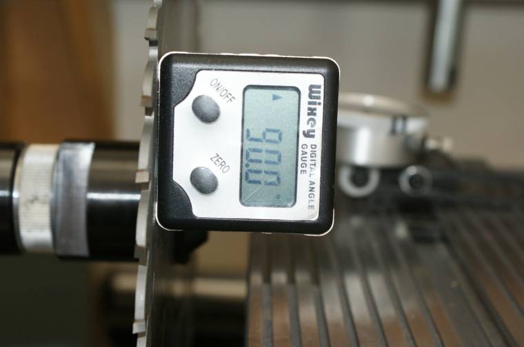

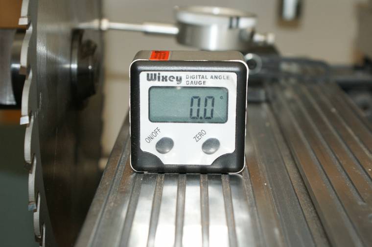

Just keep adjusting until you get these readings.
wixie on the table.jpg (86.68 KiB) Viewed 2681 times
and then this
wixie on the sawblade.jpg (81.46 KiB) Viewed 2683 times

I set the Wixey to 0.0 on the table and then check for 90,0 on the blade. Does not matter if the floor is level or not just that the table and blade are 90.0 to each other. Set the Wixey on the table and not the insert.
