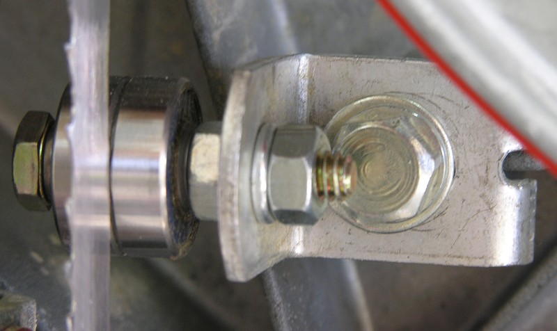

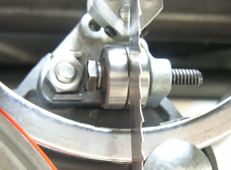

Not long ago I did a upgrade on my SS bandsaw with the addition of the Kreg fence and the Carter Guide Bearings. Both were an improvement over the standard fence and steel guides, then I looked at the Auto-Trak and Back-Up bearings and decided to try and improve on the set-up. I have greatly reduced the blade wander with the addition of the extra bearings. I have posted the pics to see if there is any interest in this subject.

I did the Kreg fence and the Carter Guide Bearings upgrades and love the results. I just compared what I have to your pictures, it looks like you replaced one wide bearing with two narrow bearings is that correct?

Yes Paul, I replaced the Auto-Trak, Upper Backup and Lower Backup bearings with 8mm x 22mm x 7mm premium C3 bearings. I simply took the Auto-Trak idea to the Backup bearings. Using the double bearing with the groove benefits all type of sawing and unlike the Carter Stabilizer the double bearing set-up can be used with all blades. I have found using the double bearing back-up that blade lead or drift has been greatly reduced. I enjoy my Shopsmith equipment and am always looking for ways to get a little more out of each piece. Have the urethane caster wheels improved the ease of movement of your MK V? I know you went through quite a struggle to get them installed. I will see how much interest is generated by the bearing photos before posting all of the component parts for the conversion. No use in wasting the forum time if no one is interested.

I guess it's like skinning cats Ed, there is always a better way. Notice how happily all blades run in exactly the same place on the upper and lower wheel of the saw, in part as a result of the groove created by using two bearings in the Auto-Trak set-up. My reasoning was to take that idea to the back-up bearings. Lead in a bandsaw blade can never be completely eliminated, only reduced to an acceptable level by various techniques, you have stated some of them in your quote. The groove in the double bearing back-up helps in that respect. Anytime you can increase the support on the bandsaw blade above and below the cut and get it to run in the same spot on the back-up bearing you will get better control of the blade and the cut quality will increase. I am using a C3 bearing and they are all the same 8x22x7 costing me about $1.75 each. Not being an engineer I approach things from an imperial point of view, if it works it works and this change does, much like the first urethane caster wheels I made for my SS from my kids scooter wheels. I am sure that we will get the thoughts of others on this subject so hopefully we will all learn a new way to skin the cat.

It rolls like a hot knife through soft butter, and even ignores small bumps in the floor. Since installing the Carter Bearings (not Stabilizer though I have it also) and putting on a new premium blade I don't get noticeable drift. Before the changes drift was so large I could not correct for it by changing fence alignment. I am interest though I might not get to doing it. Usually my biggest issue with these kinds or projects is where to get the parts.

It looks like just a screw through the two new bearings replacing the one bearing that is currently standard. What are we missing?
