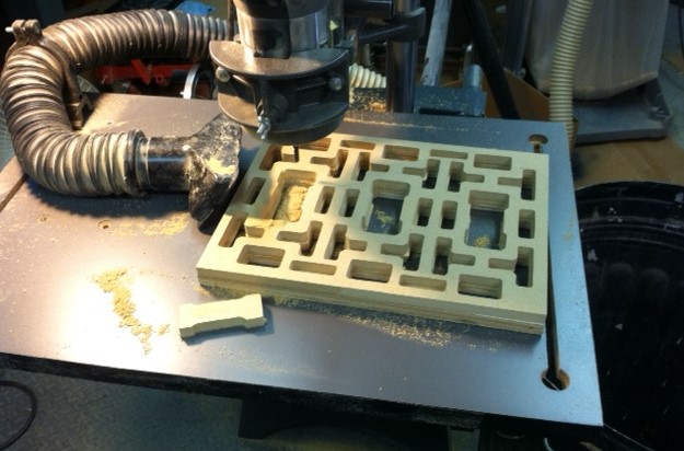

For the last few days I've been making vent covers for my neighbor. Using 1/2" MDF and the OPR with a 1/4" bit. Oh yeah, I had forgotten how dusty MDF is. The dust falls into the design during the last cut and builds up around the pin/guide. After every hole, I have to vacuum out the dust and re-rout in order to finish routing the bottom corners.
The first pic shows the buildup of dust after removing the cutout.

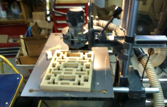

The next pic is a side view of the Mark V and the OPR.

Would a piece of sheet goods, sandwiched between the pattern and the workpiece, solve your dust-packing problem?

I feel your router dust issue. In a way it is to be expected, there is just no way for the dust to escape the trap that is created. I was seeing the same thing some years back when I was cutting out parts and had to stop and clean things out all the time.
I had an idea how I might fix this or at least improve it but did not attempt to make the change because of how rare the inserts are of the old OPR and if things did not work out I would have potentially wrecked one.....
My thought was to drill a series of hole in the insert without taking too much away as to weaken it. Then add a vacuum attachment below the table so the router dust had some where to go.
I don't have the new version so I'm not sure just how that would work but at least you would have the option of getting a new insert if need be and if it did work it would be a major improvement...... or at least even if it were a small improvement it still might be worth the effort.

Chuck, how about attaching some 1X1 to the bottom with double stick tape. That wood give ya some room underneath for the dust.
Re: Vent covers & OPR
Posted: Wed Jun 03, 2015 11:48 am
by JPG
beeg wrote:Chuck, how about attaching some 1X1 to the bottom with double stick tape. That wood give ya some room underneath for the dust.
And the pattern/pin???
Posted: Wed Jun 03, 2015 11:58 am
by beeg
A LONGER one. :rolleyes:
