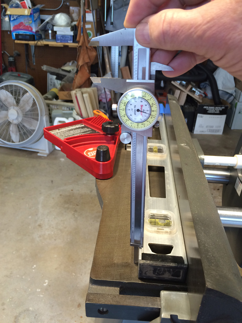

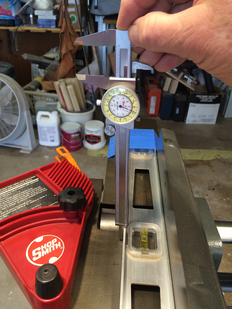

I am jointing Qtrsawn hard maple for some drawers. My first 5 boards (16 inches long) jointed flat in around 2 passes at 1/32 cut.
On the 6th board it required more passes until it was obvious that the leading edge was being tapered. The 6th board was adjacent to the 5th board from a longer piece but it was the end piece.
Since this has never happened before, I assumed it was tapered to begin with since it was an end piece so I tried a longer piece, 34 inches, and after 2 passes it had tapered 1/16 inch at the end first through the jointer. I had measured the thickness before the jointing and it was spot on the same end to end.
It acts like my infeed table has drooped away from the cutter, but I would like to find out if anyone else has noticed this and found the cause - before I start looking in the wrong area. :confused:
Thanks
Forrest
edit: I did raise the table to the zero mark and using a trusted straightedge there was no tilt of either table - flat one end to the other. So it must be technique? I have been jointing for years (boards, not bars :p ) and have not changed my technique. Especially on the shorter boards my push pads covered the whole thing. 5 went perfect, then 2 started bad using the same technique? :confused:
edit2: I ran the infeed down and measured the offset from the cutter edge to the trailing edge.
I can see no more than 1/128 taper - but that could easily be measurement error. The level at those 2 points is 1 0/128 inch.
