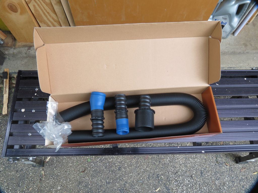

Inside is the very flexible hose, according to them it is able to go from the 3 feet compressed to 15 feet when stretched. I didn't test that, sounds reasonable. It has a 1" and a 1-1/2" rubber port that is flexible. I doubt it fits everything and again I did not test all of my equipment to see if even fits everything I own. Then there is a 2-1/4 port for the vacuum. All the ports swivel which is really a nice feature. Inside the box after I opened the plastic bag of attachments:

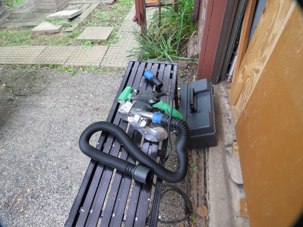

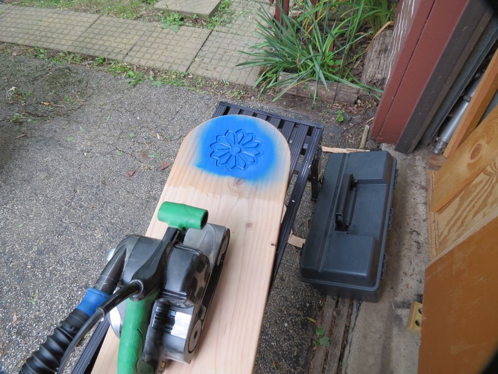

The attachments simply screw in to the hose, the one for the vacuum I will leave on and then switch out the other two as needed. Well that is the plan anyway. Today I had two sanding projects so this is how things went with them. First I wanted to sand the paint off my design on the plank chair I made. To do this I wanted to use my belt sander, an Hitachi, the hose slipped on and away I went.

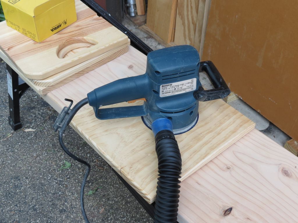

The second project is a little table/chair/setup stool for a granddaughter. For this I wanted to use my Bosch random orbit sander. The hose fit that as well.
The hose is heavy and does weigh you down somewhat and there is no clips or way of attaching the cord and hose together. I'm not sure that would be a good idea but something I might play with in the future. I have an arm, also sold by Rockler that lifts and attaches the hose so it stays out of the way and I think that will help with the weight issue but I did not verify that yet.

I just got this kit as well and do like it. However, the hose slips off my Dewalt D26451 Palm sander. Have not given up yet....

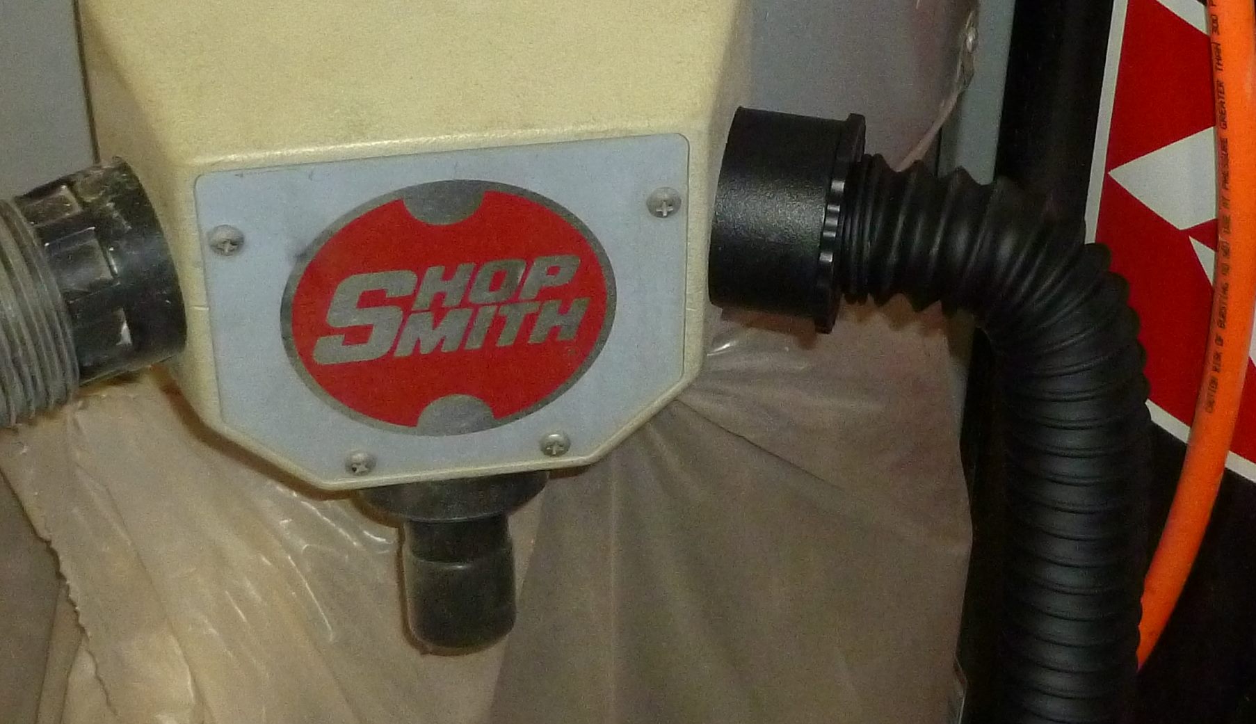

Looks great. Does it fit the Dust Collector and the Shopsmith ports?
Re: Today in the shop (FLEX ABILITY)
http://www.lowes.com/pd_37045-20097-906 ... 85001&pl=1 This is what I use on mine. Cut off the first section.ChrisNeilan wrote:I just got this kit as well and do like it. However, the hose slips off my Dewalt D26451 Palm sander. Have not given up yet....
Hi Dusty,dusty wrote:Looks great. Does it fit the Dust Collector and the Shopsmith ports?

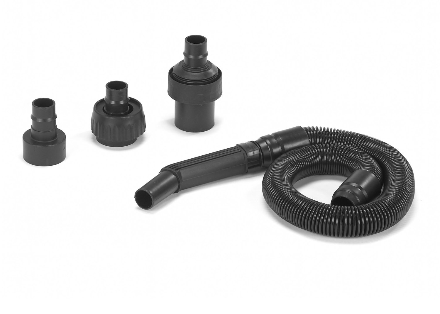

Yes and No. It does fit the DC It's ShopVac's quattro hose so it's adapters fit any standard systems
But the two blue adapters are meant for 1" and 1.5" exhaust ports (so maybe the old belt sander port??)
I think it is too short but if I want to add to the hose, it is almost cheaper for me to buy another one from Rockler and a coupler than to buy the Shop Vac pieces on Amazon!!
