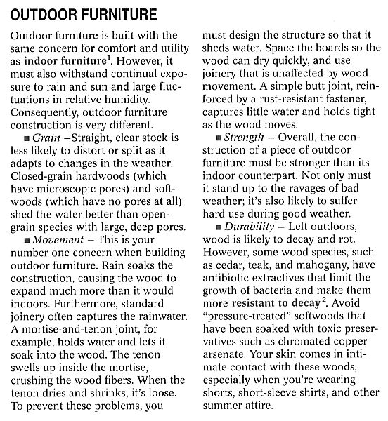

From Woodworking Wisdom by Nick Engler. Mr. Engler also wrote Outdoor Furniture, Outdoor Structures, and Benches, Swings, and Gliders.
[ATTACH]1308[/ATTACH]

- Outdoor Furniture.jpg (127.86 KiB) Viewed 12551 times

Thanks Nick! And in keeping with Mr. Engler's quoted work above, I was recommending them for a bench protected from the rain! (Totally by accident, but even a broken watch is right twice a day.Nick wrote:"Another possibility is through tenons with a dowel. (Can't remember the name of the joint, sorry.)"

Nick's comments are right on. You want joints that don't have the possibility of collecting water. Water collected in a joint today means a rotted joint tomorrow. Keep the design so the entire piece can shed water and dry out. A good square butt joint glued with yellow outdoor glue will be a good way to go. If you use screws to join pieces don't counter sink because water can collect in the recess and lead to rot. I learned that the hard way. I like to use redwood for outdoor furniture however, it is very soft but easy to work. The downside-- my yellow lab did chew up (read ate) a very nice contoured Adirondack chair!!!
San Diego
