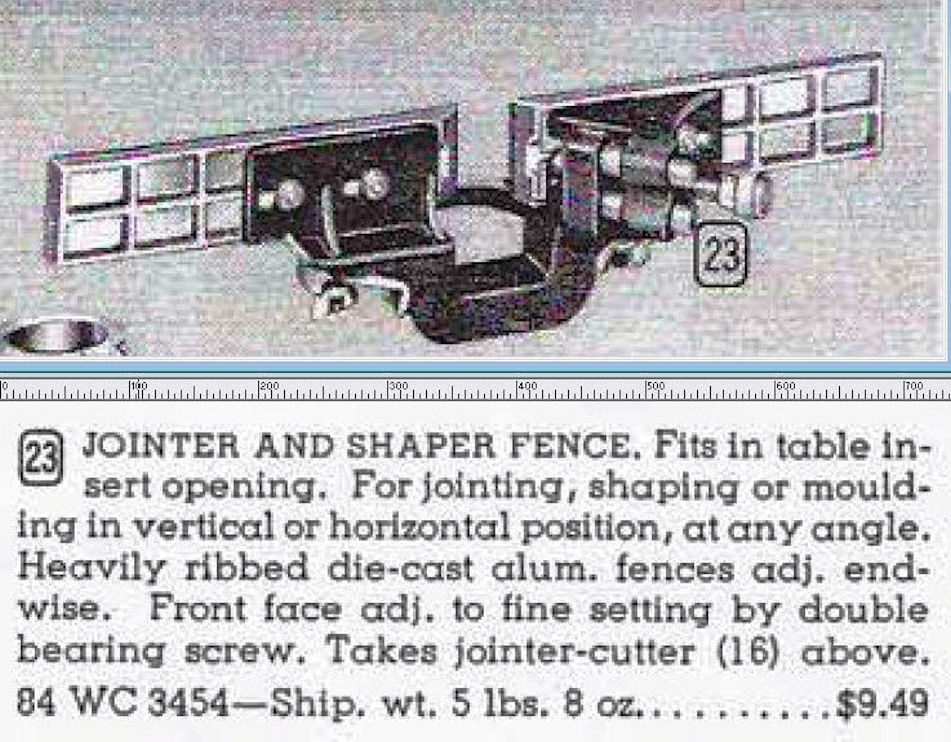

I found a reference to it in a pdf file of a Montgomery Ward brochure:
jointer and shaper fence off M Ward cat.jpg (181.04 KiB) Viewed 4924 times

FWIW they also come with wood fences.

And, anyone interested in getting one, the Mk5 500 fence WILL fit.
And, is MUCH better than the Model 10 one.
steve

Concerning your post #191454 (Jointer Shaper picture). Thanks! I have one and didn't know how to "hook it up." Seems that it goes into the hole in the table. If you have additional suggestions/literature for safe use and installation, please let me know.

FER wrote:Concerning your post #191454 (Jointer Shaper picture). Thanks! I have one and didn't know how to "hook it up." Seems that it goes into the hole in the table. If you have additional suggestions/literature for safe use and installation, please let me know.
FER
You will find most all documentation and manuals for the 10ER here http://vintagemachinery.org/mfgindex/de ... =747&tab=3.
And Here: http://vintagemachinery.org/mfgindex/de ... =338&tab=3
Have fun! :D
