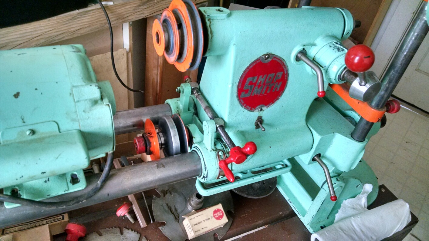

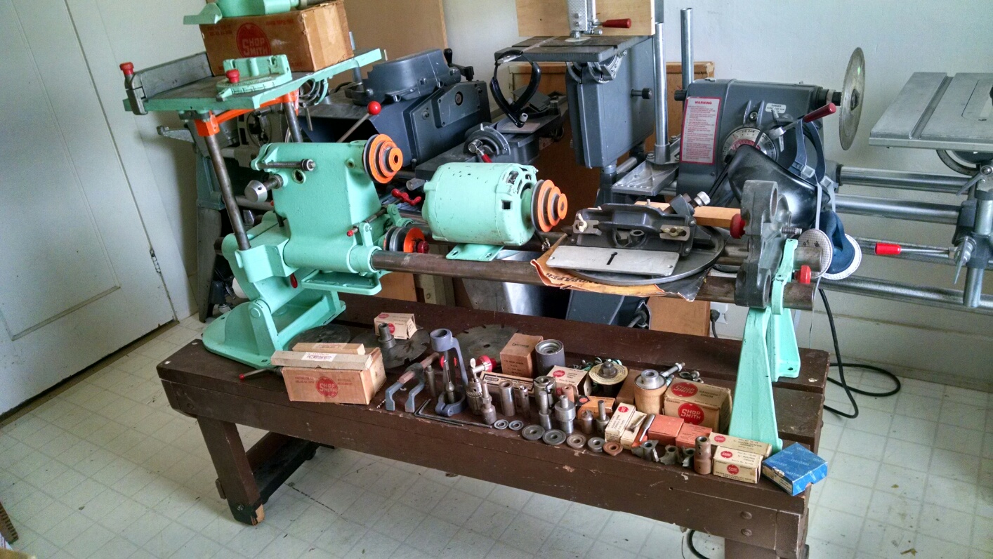

I've wanted a 10er since I heard of them but had not seen the right deal. Last week I cleaned my shop as I began installing a dust collector, so suddenly I had room to spare [read: "stand"]. I saw an ad on cl for a 10er, seller's father was original owner, looked complete and in good shape, had speed control and many original little boxes of parts. It's in great shape as it turns out... Needs at least one bearing (I'll likely replace them all), very little rust except on the exposed ends of the tubes where the tailstock goes. I have not gone through it enough to want to run it yet but I have a motor I can use if this one is somehow doa, though po says it runs and it feels nice. Includes a while lot of smaller components like arbors, Jacobs Chuck (& key) shaper cutters, morticing chisel setup, tiny little 10(?) inch sanding disk, but it also has a flex shaft and a jigsaw. He included a black and Decker r.a.s. for free, may fix up: $125... But it sure is an odd color:
It is either an original paint job or a very professionally done job, I suspect the latter.
SN er18668
Any suggestions on dating it?
Posts: 6585
Re: Man, these 10er's are HEAVY! New beast in the stable.
Good price and looks to be in good shape. The speed changer is worth more then what you paid for the whole machine.
Color,yuck!!!! It is not original

You definitely got your money's worth on that. Nice find. Like John said, the speed changer is worth what you paid.

Color original - PO original choice.
Yucky? A matter of opinion(I sorta like it).
A bargain fer sure!!!!

I go back and forth on the color. As a color for a machine I like it. Looks better in person (camera adds 10lbs, etc...) Now, I'm colorblind, but those who are not have all liked the color. However, for a machine that is a Shopsmith it looks wrong. I think I'll repaint it somewhere down the road. Way down the road, most likely.
