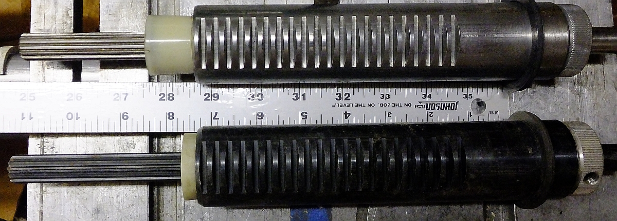

The quill splined shaft is slightly longer on the MV.
QUILL MVII - MV TWO BEARING A.jpg (519.34 KiB) Viewed 833 times
Note the difference in the coupler. Drive shaft 'nest' the same dimensions but no retaining spring on the MVII. Quill shaft splines are shorter on the MV coupler.
QUILL MVII - MV TWO BEARING B.jpg (460.88 KiB) Viewed 833 times
Both will pass into the MV quill body, but the MV coupler drags slightly on the MVII quill.
QUILL MVII - MV TWO BEARING C.jpg (412.3 KiB) Viewed 833 times
I think it could work with shortening the splined shaft, and retaining the MVII coupler. The drive shaft is slightly different requiring the MVII coupler.
