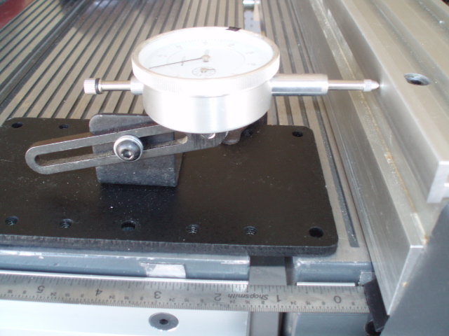

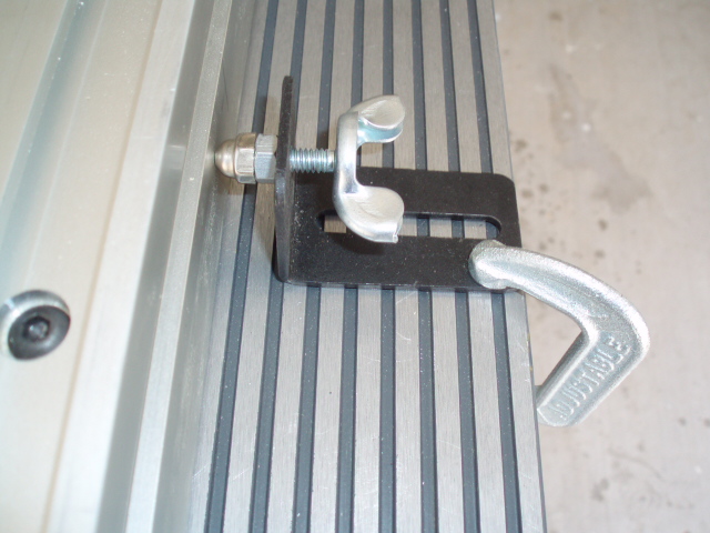

During Sawdust Session #18, Nick demonstrated the use of the dial indicator to accomplish a very fine adjustment of the rip fence.
I went to the shop to try out the technique. It worked real good for Nick but I just could not move the rip fence in increments that small (.002" or .003").
Maybe Nick didn't either - he never did show us the dial face. His box joints (finger joints) worked out good though, so he must have made the adjustment he wanted.
But now I want to microadjust my rip fence. I set out to rummage through the bits, parts and pieces that I have carried around for years to see what I could find. I didn't find a microadjuster but I found some parts and some inspiration.

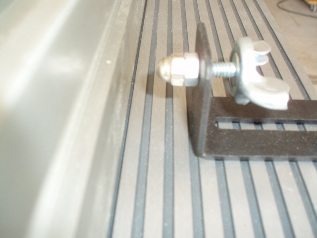

What I have here is just a concept but it'll work - in time.
I hesitate to drill into the fence, so for the moment, I can push the fence one direction but I cannot drag it back. That seems to be a simple problem but we shall see.

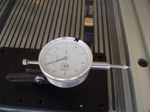

Watching the dial indicator, I had good control and could stop at any point. Make sure the fence is firm against the cap nut when I lock down the rip fence and I'm done.
One complete turn of the wing nut pushed the fence 52/1000" (.0052") so I have good adjustability/accuracy.

I am thinking you could use the slot in the rip fence somehow to make it easy to install and remove. In general I love the idea.

Let me put on my disguise so I can tell you this incognito -- if you take Dusty's good idea just one step further, you don't need the dial indicator. Replace the bolt in Dusty's jig with an #8-32 bolt -- 32 threads per inch. One turn of the wing nut will move the fence 1/32"; 1/2 turn, 1/64", 1/4 turn, 1/128". If you like working in thousands as I do, 1/8 turn will move the fence within 1/10,000" of .004", and 1/16 turn moves it within 5/100,000" of .002".
