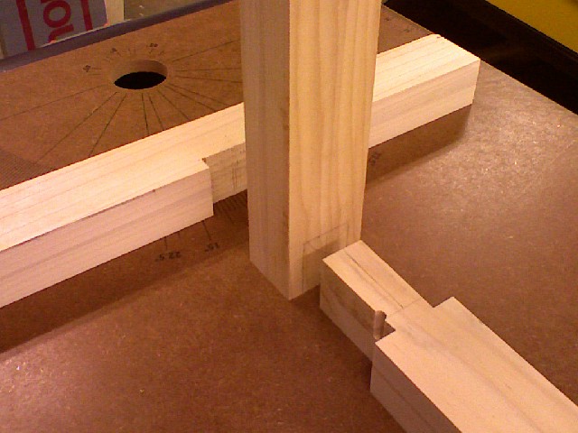

I need to make an accurate cut on the end of a 1 1/2"x2"x24" piece of popular. The cut is what I will call a saddle which fits over a tenon. The cut is about 1" wide x1 1/2" deep. To clarify see picture below.
Sounds easy, huh? But I need square sides so the saddle fits over the tenon and this saddled tenon fits square and tight into a 3/8" groove in an adjoining piece. Incidentally, this configuration forms the base of a tilting table for my laptop.
The cut!! Cut it like a tenon with a tenon jig? If so, how do you stabilize the 24" vertical piece? Band saw or sabre saw? Don't think so, not accurate enough. Even thought about laying piece flat on the ss, but can't get a flat bottom. How about securing the piece to a sacrificial fence in the mitre gauge? Secure it somehow in a sliding table?
Suggestions welcome.
- saddlecut.jpg (73.43 KiB) Viewed 9220 times
