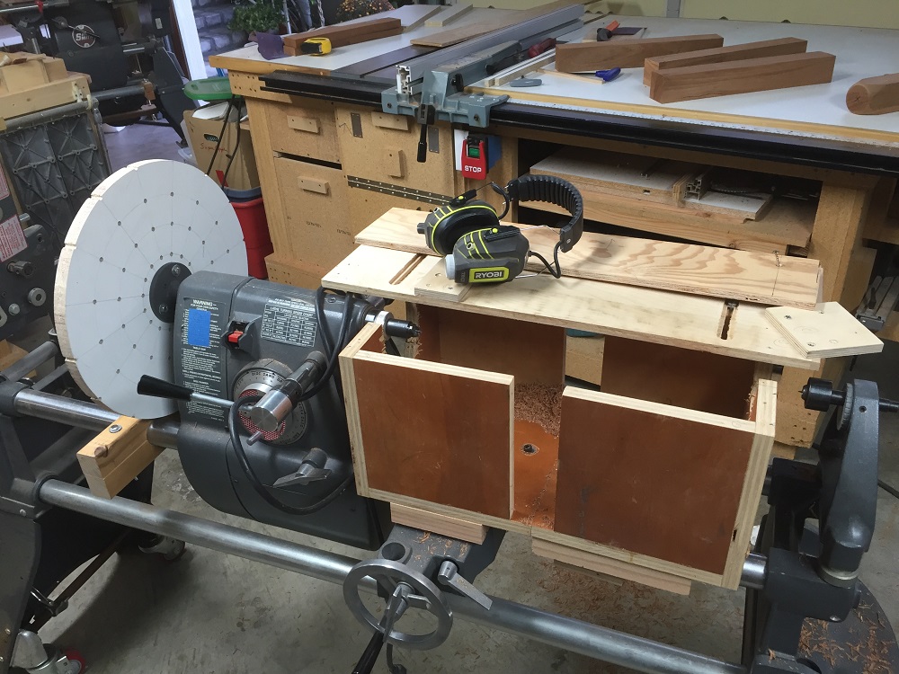

I finally got some free time and was able to begin the project. I decided to start with the legs as they tend to be the most difficult for the boss to decide upon. It required building 4 prototypes before I got approval. The design is more art deco than anything else and as usual it will be a combination of padauk and Honduran mahogany. I made the padauk rings first because I felt it would be easier to adjust the rest of the leg to the ring than the other way around. The lower spindle I knew would be the part that she would have the most issue with and that was the part that required four tries to get right. I used an indexing router jig attached to the SS to produce them. One version had 12 facets which was rejected for the four sided version. The top piece in the picture is actually two pieces and will be cut in half. More to follow.

Re: Next Project
Posted: Sun Nov 22, 2015 9:50 am
by carbonman
What is the box "thingy"?
What is the white wheel on the left?
Very nice work.
Re: Next Project
Posted: Sun Nov 22, 2015 10:41 am
by Bruce
carbonman wrote:What is the box "thingy"?
Very nice work.
The wheel is an index wheel that holds the workpiece in place so you can use a router to shape the workpiece. I assume the box is a jig of some sort that guides the router to make the tapers on the mounted spindle. The original poster can explain further. It is nice work.
