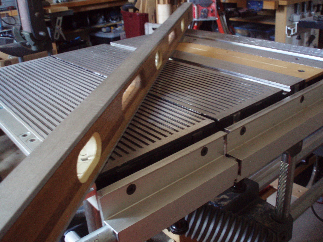

Using your chosen straight edge, check all four edges and both diagonals of the Main Table for flatness. If all six measurements are exactly what you were hoping for, consider yourself very fortunate. None of mine are what I would like them to be. My Main Table has a high spot near the center of the table. It is not a major issue but the table is not flat and I am not certain that all four corners are in the same plane.

- Main Table Rt Rear Corner Low.JPG (1 MiB) Viewed 3444 times

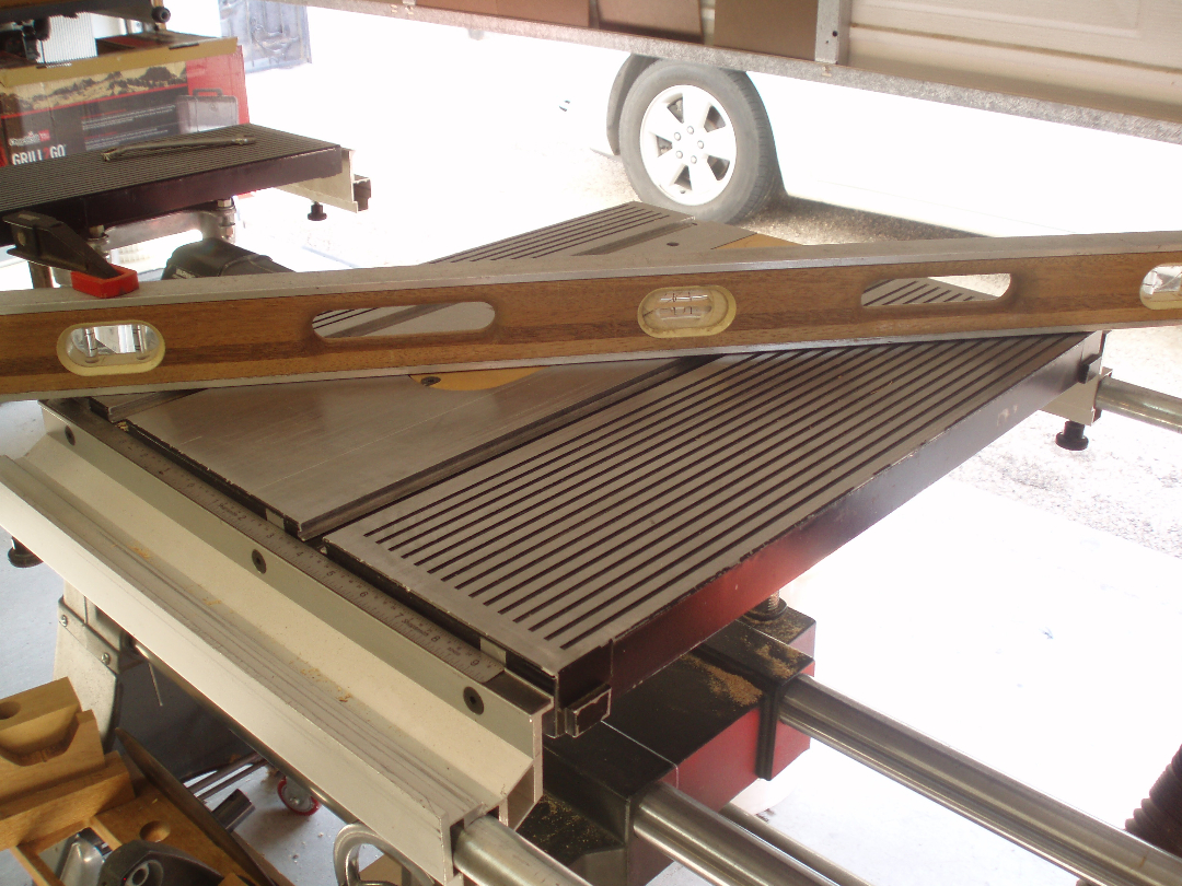

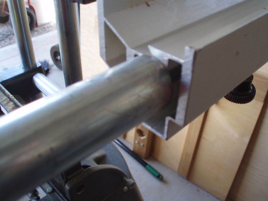

At this point I move the Carriage to the right until the right edge of the Main Table and the left edge of the Right Extension Table Align vertically. After adjusting the Extension Table so that its height approximates that of the Main Table, I loosen all of the nuts that secure the Extension Table. Then I insert a pair of tubes through the rails of the Extension Table and the Main Table and tighten the screws that secure the tables to the rails. Hopefully this creates a flat surface and an almost disappearing joint between the Main Table and the Extension Table. The Extension Table has just become a 7" extension of the main table.
It is at this point where I secure those bolts and nuts on the bottom of the Extension Table. Before doing that, move the support leg up under the Extension Table so that it just touches but does not move the table. After securing the Extension Table to the support legs, I remove the extension tubes from within the rails hoping that when I do so the tables remain in the same relative position. If they do not, something has been done incorrectly.
Checking this pair of tables from corner to corner diagonally will tell you whether or not you have been successful. Remember the results for when you did this with just the Main Table. Those results will have some bearing on what you experience here.
Again I say, perfection is NOT going to be achieved.

- Verifying Diagonally.JPG (1.37 MiB) Viewed 3420 times
