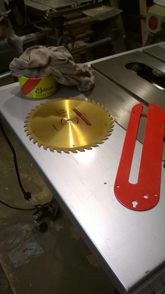

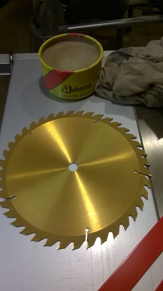

Now this is a clean blade!
A bath of Purple Power, followed by a coating Johnson Paste wax!
- tablesawblade1.jpg (40.82 KiB) Viewed 3421 times
- tablesawblade2.jpg (45.72 KiB) Viewed 3421 times

This blade reminds me of a golden record... lol!

I dilute is, about one-third water, two, two thirds PP!
