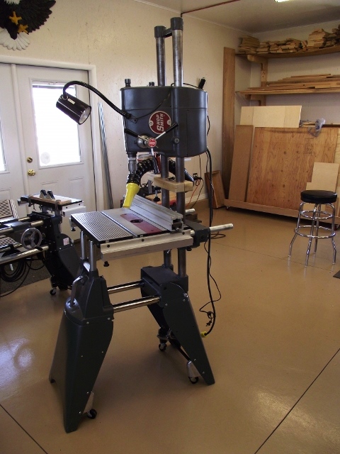

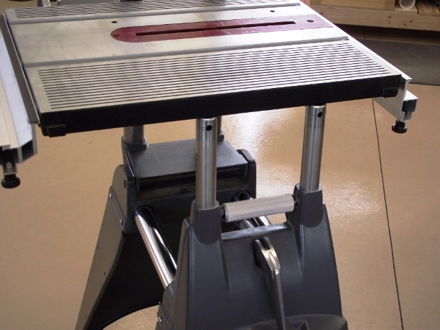

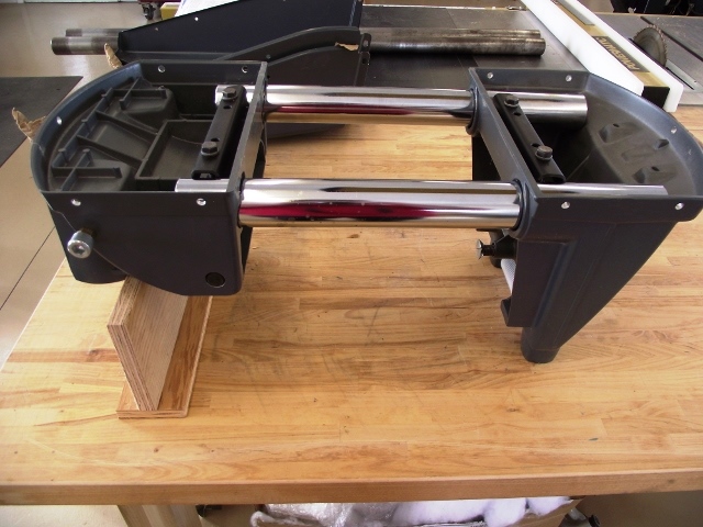

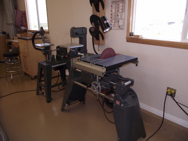

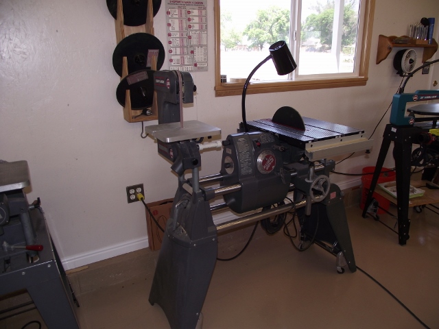

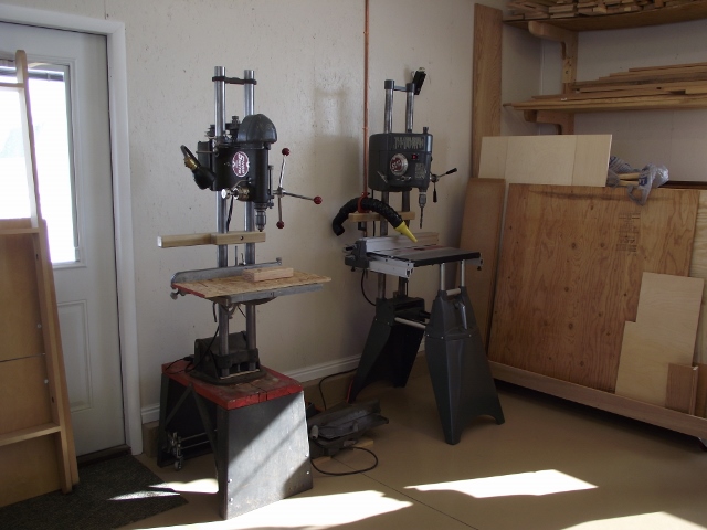

I have two of my SS set up for dedicated tasks. There is a shorty that serves primarily as a sanding station (Disk, Strip and Belt). I also use buffing wheels on it. The second one is a dedicated drill press.
- DSCF1167 (640x480).jpg (202.71 KiB) Viewed 5655 times
- DSCF1168 (640x480).jpg (216.86 KiB) Viewed 5655 times
- DSCF1098 (640x480).jpg (206.84 KiB) Viewed 5655 times

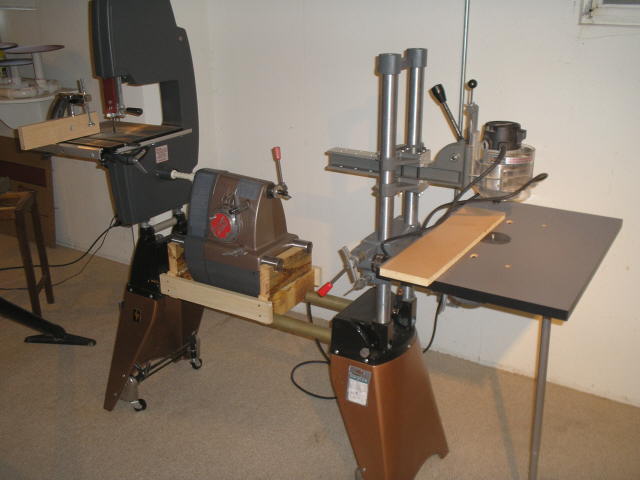

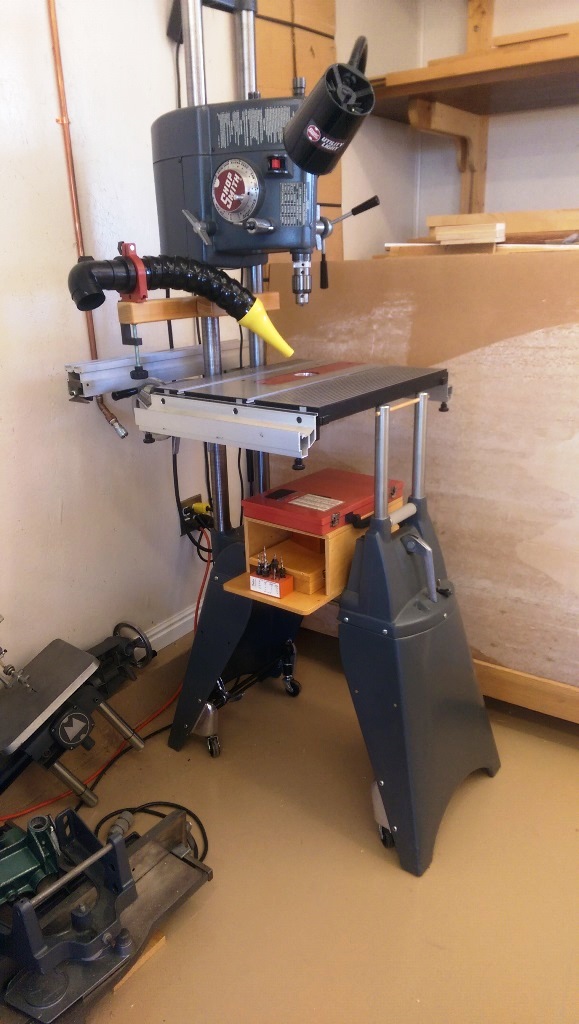

Besides my PowerPro 510, next to it I have this Rube Goldberg (or GoldHeadstock) machine...

jsburger,
What is the length of your tubes on the Shorty dedicated drill press? Is it stable? And what are the footprint dimensions?
Also I'm curious about the setup of your drill press table. How do you attach the tubes to the table and can you provide more details on what you did. That looks really slick.
BTW. Great looking shop and setup.
Thanks. Steve
Thanks. Steve

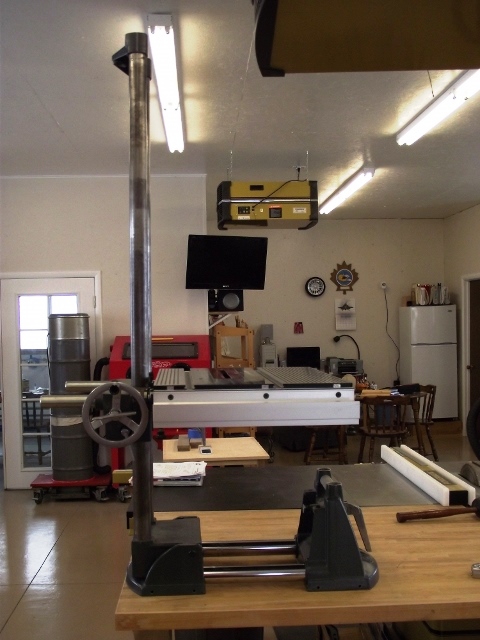

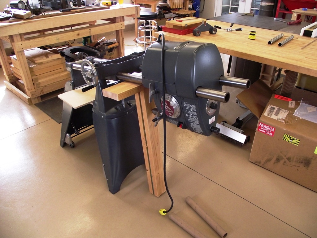

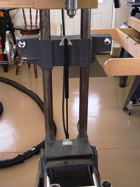

Re: Multi purpose dedicated shopsmiths (pictures please)
The head stock and the end castings came from the upgrade of my full size MK V to a MK 7. All of the rest of the parts came from eBay except for the table raiser. The way tubes are thick wall 10ER tubes. They are not cleaned yet in all of the pictures except the last one where they are cleaned.cooch366 wrote:jsburger,
BTW. Great looking shop and setup.![]()
Thanks. Steve
The bench tubes are the 18" pieces I cut off to make the shorty sanding station. The base is assembled with the tubes inserted in the end castings as far as they will go.
The table carriage, table and head stock are installed on the way tubes 180 degrees from normal. That puts them over the bench so the whole assembly is rock solid.
The tubes at the front of the table are not attached to the table. They are held in place by the end casting lock. The tubes are the old main table tubes from the double tilt upgrade of my full size MK 7. If you look at the last picture I put a 1/4" dowel through the holes in the end of the tubes so I could raise both of them into position with one hand and have a hand left to tighten the lock.
I also installed a table raiser. However, I don't move the table very often but it does help when I have to move it. It can't be installed per the SS instructions since everything is turned on the way tubes but the installation is straight forward.
The foot print is 19" X 33". Because the head stock and table are turned on the way tubes to be over the bench it is absolutely stable. With the solid support provided by the tubes at the front of the table you could stand on the table and nothing would move.
The last picture shows it as it looks today with the way tubes polished and some storage space underneath.
