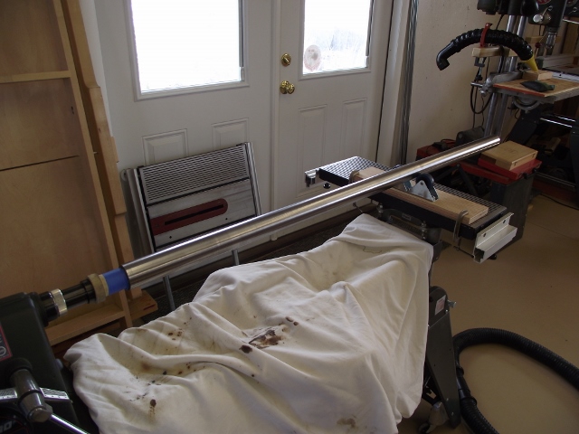

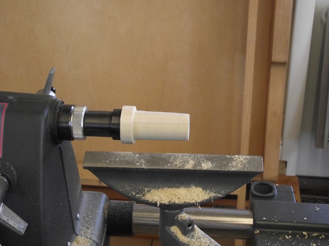

I used a tapered wood plug on a screw center before I got a Nova chuck. The other end was supported by two cheap Harbor Freight castors screwed to a piece of plywood and clamped to the aux table. The wood plug gets worn after the first use but just wrap a few layers of painters tape around it and you are fine. Tap the tube lightly on the end to seat it on the plug. It holds just fine since you don't need a lot of pressure with the sand paper.ERLover wrote:I want to polish/derust 2 ER way tubes, I looked over the Threads in maintenance and repair, JPG stated in one of Bills, that a 1 3/8 diam freeze plug for the ERs, well, the one I bought just wont go in. I dont know if a
1 1/4 will expand enough.
Secondly I thought I had it saved, a thread/pic of a support set up that the person used some castors or skate board wheels at the tail stock area. Any help would be appreciated as always.

My rig was very similar to John's. Just turn a tapered plug (you may have to take a hammer and a board and force it on again periodically, it doesn't take much to support the "free" end, I just just a V jig of 2x4's(actually a X
) with aN arm connected to the extension table hole (another plug) to stabilize it. Used a power drill with a wire wheel in it. They came out perfect!

Thanks all, one done and the other after lunch settles. Cleaned up the freeze plug to fit and used the same rollers/castors as JS. I do/did feel a bit nervous with about 25lb of spinning metal in front of me.
