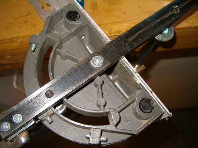

Here's the screws I'm talking about. They are the glides that look like 1/2" hex screws. They are black in color. The ones the miter gauge rides on.
The screw is 5/16 X 18 TPI
[ATTACH]1424[/ATTACH]

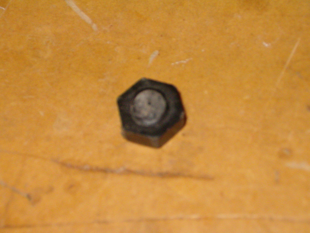

Here's the 1/2" head I had twisted off.
[ATTACH]1425[/ATTACH]

charlese wrote:Here's the screws I'm talking about. They are the glides that look like 1/2" hex screws. They are black in color. The ones the miter gauge rides on.
Hope this clears up the confusion!
Where was the head that you twisted off. Attached to the top or bottom of the set screw?
My glides look like your except I have slot on the top side so it doesn't get worn off. Mine do not have a hex head like you shown broken off. In the picture you glide mounted in the miter gauge don't seem to have head either.
I'm still lost

I can concur with what both you and charlese have said. There is a pair of flat hex head nylon screws in my miter gauge and there is a pair of set screws.
If I take the flat head nylon screw and the steel setscrew out, there is a hole (vertically) all the way through the fence on the miter gauge. It is threaded most of the way. The top part of the hole is not threaded.
It sounds to me as though you are using a nylon set screw in lieu of the nylon glides and do not have set screws at all.
The set screws in my two miter gauges are coming out today and going into the spare parts drawer. I never have a need to tighten those set screws. I abandoned the old method of testing rip fence alignment a long time ago.
I'm taking them out because I suspect that charlese' problem is an indirect result of those steel setscrews. If one tightens those setscrews down onto the tip of the nylon glides, I fear that the glide will spread and be lodged in the hole - begging for the nylon glide to break off. New glides probably wouldn't break under normal pressure but older, more brittle glides might. Mine definately qualify as older.

Exactly, Dusty!!! This is what I tried to explain in my first post. Actually, $12 bucks isn't really too much when you consider the new screws need a nut driver or socket to get started, and then need the slot in order to adjust. This is one part I would rather buy than make. The slot is wide and must stand up to a bit of torque.
As earlier reported the excess nylon must be cleaned off the threads in order to start the screws. The excess nylon on the other threads of the screw prevent vibrating out, but they also cause the screw to fit pretty tight.
I think I mindlessly screwed down one of the metal allen head screws to prevent the nylon screw from being moved.

As for the part that was snapped off of the head - I had bored a hole through it and after removing it, broke it apart with pliers just to see what it was made of. As for my extra glide - I put it somewhere I knew I could find it. Couldn't find it this morning to take it's photo! Isn't that the way it happens sometimes? When I locate it, I'll send you a photo.
