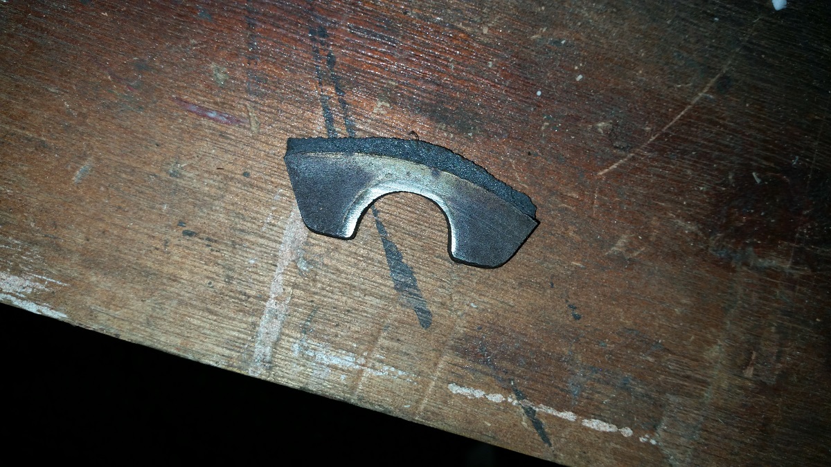

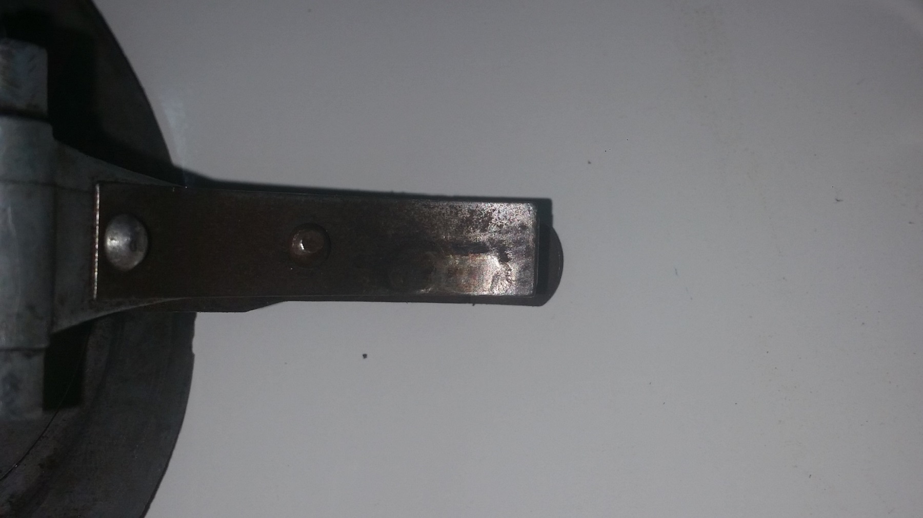

While assembling the speed control I noticed the ware on the spring steel on the "pork chop" is quite off centered and the ware on the button is also off to one side and tapered. Should I be concerned about this?

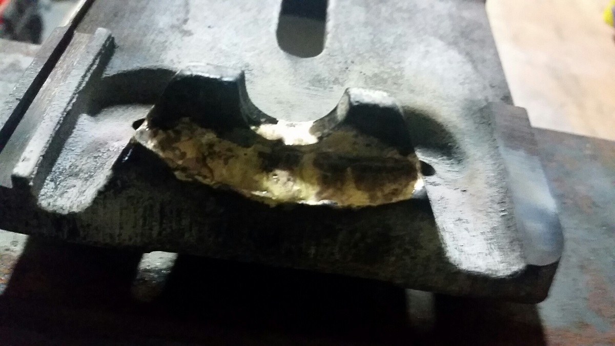

The speed control sheave also has a small crack, I have braised it up and filed smooth, fingers crossed it holds up.

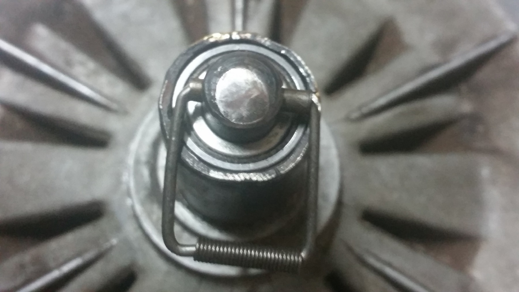

#1 shows a bright spot on the end of the "button" installed in the bearing on the control sheave. This wear and your mention of it in your second paragraph indicates to me that the bearing in the end of the control sheave has frozen at some point in time.
#3 shows a correct assembly of the loop spring and the button in the center of the bearing. As you can see, the button should not turn with the shaft. The button and the inner race of the bearing should remain stationary and only the outer race of the bearing should rotate with the shaft.

IIWM, I would straighten the wire clip. It should have a rectangular shape. The ends are inside the tension pin.
I assume the discoloration was caused by the brazing.
I venture to guess the wire mangling was caused by the bearing/wire being pulled out of the control sheave hub. Also a likely cause of the 'crack'.
I am not concerned re the shiney button. As long as the button is 'smooth' it should be ok. All it does is slide on the porkchop when the speed is adjusted. The wire clip prevents the button from rotating with the hub. The porkchop should NEVER pull the wire clip. The sheave is pushed 'out' by belt tension(the floating sheave/spring's job). The button does however hold the control sheave in position along the idler shaft.

I am glad to see brazing is a viable repair of a control sheave hub. You are the beta test!!!!

Thanks again for the guidance. You are correct JPG, the blue coloring was caused by the brazing. I figured why not have a go at brazing it up, being so far from a good supply of parts it was worth a go. Happy to beta test LOL

The bearing is a little bit loose inside the control sheave, i believe this is my fault from when i removed it. Although from the video i watched on YouTube it doesn't look to be the tightest fit and that why the top is crimped a bit to help hold it in place?
