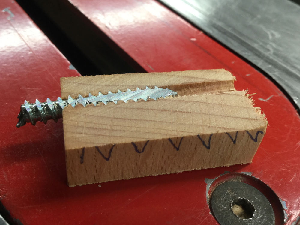

Yesterday, I dismantled an old solid-oak desk. I had planned to rebuild it, which would have involved making a brand-new tabletop. But on closer inspection, I discovered that the structural design was flawed, which explained why the beat-up old tabletop had split in several places. So I decided to simply dismantle it, and salvage as much of the wood as possible.
Several #10 reinforcing screws that I had added about 25 years ago broke off during disassembly. So before storing the wood on my lumber rack, I marked the locations of all the broken screws, and set about slicing the wood into usable screw-free pieces. But then I got in a hurry, and ran the saw blade right into a screw that I was attempting to cut away. :eek:
Of course, my good glue-line rip blade was mounted on the Mark V, and I was sure that I had wrecked it. It's a Freud LM75R010 with triple-chip grind. And when everything is set up properly, it makes beautiful cuts indeed.
The funny thing was, I didn't even know that I had hit the screw until I saw it's shiny new surface in the cutoff piece. There was not even a difference in the cutting sound, at least that I noticed.
Screw slice.JPG (601.16 KiB) Viewed 5975 times
Fully expecting to find chipped teeth on the blade, I inspected all of them. No visible damage. Then I felt the edges for sharpness. Only the left side of the teeth hit the screw, and the left edges still felt exactly like the right edges. Then I made a couple of test cuts, and still found no sign of blade damage.
So the carbide was the clear winner in this contest. I'm accustomed to seeing carbide tooling cut all manner of steel in machine tools, but was still surprised that an ordinary wood saw blade could make a cut like that and come out unscathed. Score one for Freud's "TiCo Hi-density carbide with titanium"! :cool:
