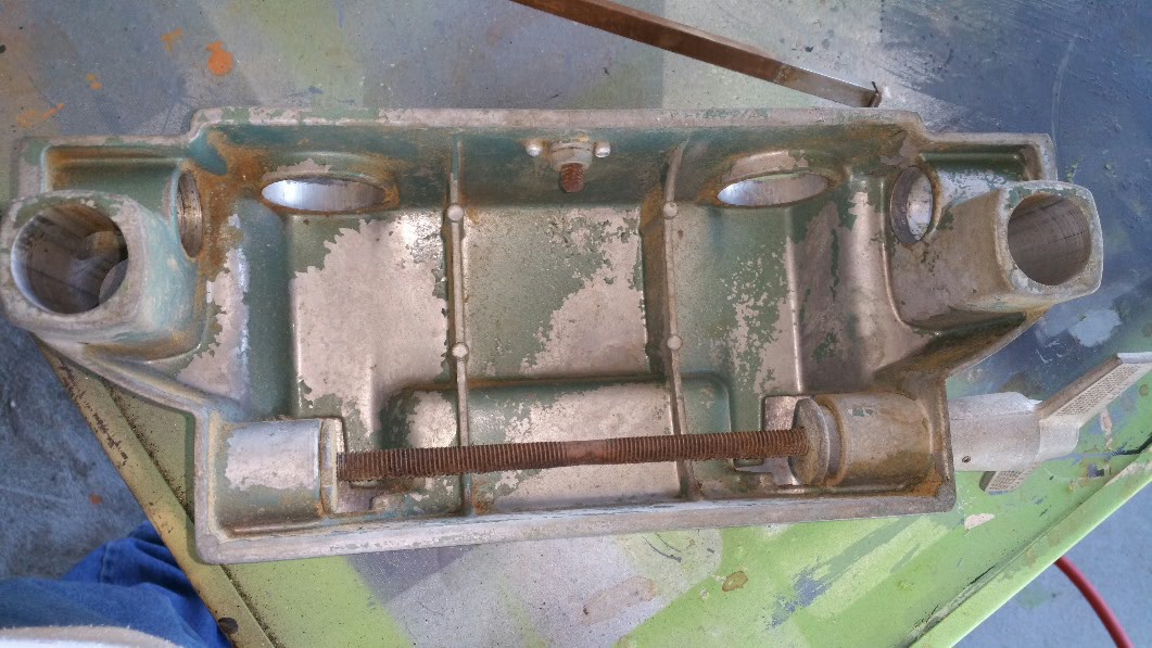

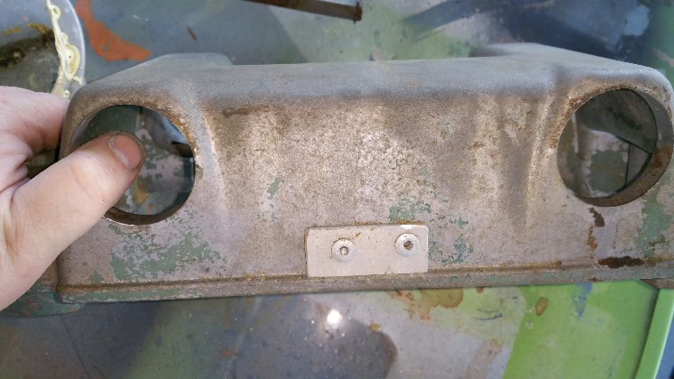

Tbh this came off a greenie that was given to me by a lady that thought it was broken.
You can have it for the cost if shipping. Between upgrading to a 510 table system and some of my other acquisitions, this will simply collect dust on my shelf.
2 points to mention:
No height adjustment lock. The pinion gear movement is there though. It just don't lock.
It looks as if someone repaired a crack at some point in this machine's history. I never even noticed it until I cleaned it off to put in a box for you.
I've posted photos . if you still want it, let me know. I'll get a price for shipping to you

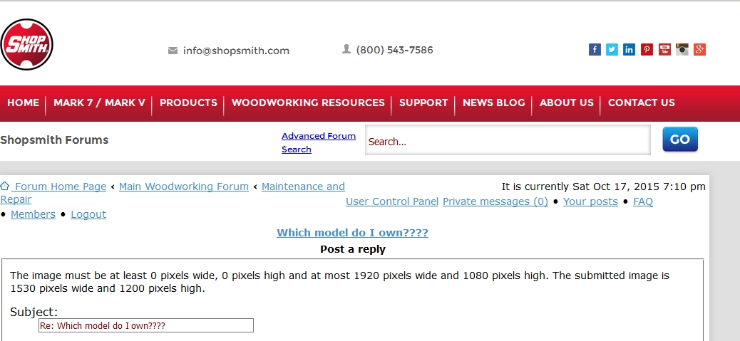

I am not a very computer savvy person, and a bit confused with the "posting pictures "
I tried sending 2 pics earlier and I see they didn't send.
How do I know how many pixels I have? And how do I lower the pixels to be able to send them??? I'm sorry,,,, I just don't know how to do it lol
