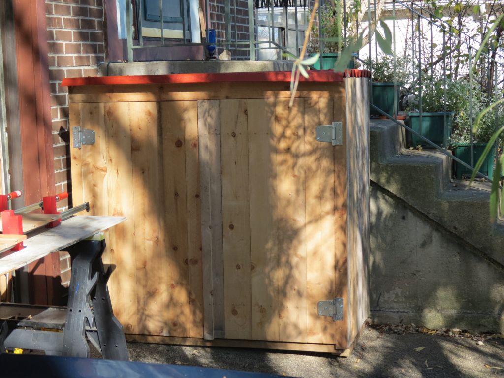

This past summer our city decided it was time to change things up again by going to a garbage and recycling container system. The heart of the system are carts that you now use to put your recycling and garbage in. The carts are designed so the "garbage" person stays in the truck and pulls up to your receptacles and an arm grabs them and dumps them. So while new for us this has been coming for a lot of years. Many near by towns have been doing this so you might have already had to deal with this issue.
The issue is that the carts come in fixed sizes. Even the small size we selected is larger then the previous space we had been using. Even the special container that I made some years ago was to short so for the last couple of months ours have been sitting in the backyard. Unsightly, was the least of my concerns but we have animals that would have no problem knocking over these containers and checking out the content........ I'll let you think of other issues you might have but I have a solution for my issues.
First I decided that I would put this in the front, it would not be my first choice but for the fact that it will be easier to deal with in the winter. But a little voice told me that the City might not like this idea and or we might change our minds or any other combinations that might come up.

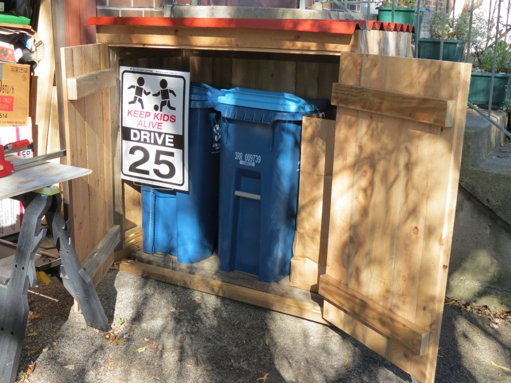

So using my kreg HD system I made a treated 2 x 4 structure and then did panels for the rest of it. If it needs to move I can take out 4 screws and remove the top, 4 more screws and the sides come off, two more and the back comes off. If necessary I can unhinge the doors to lose more weight. I went with cedar so it is pretty light all things considered.
The roofing material is something I've used before, had to special order it this time as they did not have any in stock. So it went roof less for a while until that came in.
I have yet to put a closure on the doors. I'm thinking perhaps something wooden that is simple and easy to do with one hand. If anyone has an idea please post.
With all that said it time for the pictures.
IMG_9990 sc.jpg (151.67 KiB) Viewed 1975 times
Nothing fancy.

Looks sturdier than most houses.
Re: Today in the shop (World keeps changing)
Short 'board' with a screw in the middle. Think butterfly storm window retainer.
