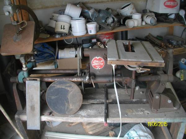

While we're on the subject, Magna did make brackets and headstock pulleys for using Mark V SPT's on 10ERs. But the original ones are quite rare. The one in the photo below is the first one that I've seen in the wild. This machine is currently on the Columbus CL, with an asking price of $350 OBO.
Mighty rusty, but it does include the Magna "Adapter A", special headstock pulley, and a speed changer.

Damn Dennis, if that was closer ....BuckeyeDennis wrote:While we're on the subject, Magna did make brackets and headstock pulleys for using Mark V SPT's on 10ERs. But the original ones are quite rare. The one in the photo below is the first one that I've seen in the wild. This machine is currently on the Columbus CL, with an asking price of $350 OBO.
