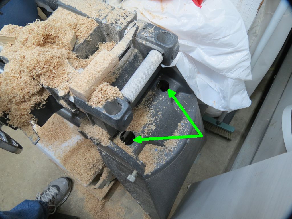

So I think I understand what you said but to be sure below is a picture. Keep in mind this is a double tilt but the principal is the same. The holes where the tubes are hitting are the ones I have the green arrows pointing to?

by donalexander
You've got it. The tubes of the table are hitting the outside edge of the lower holes - the one's your picture has the arrows pointing toward. In fact where the arrows touch the holes is the point of the problem.

by reible
Could you check the diameter of the holes? They should be about 1-1/2".
I assume you don't see anything bent or looking cocked off at an angle when it is just sitting there right?
When the table is mounted up high do the tubes look vertical?

by algale
My guess it the bench tubes/way tubes are not inserted the correct distance into the castings....
Re: Accessory Table problem
Posted: Sat Dec 05, 2015 8:40 pm
by reible
algale wrote:My guess it the bench tubes/way tubes are not inserted the correct distance into the castings....
That is my line of thought as well. You should be able to see this as it will have to have a pretty good angle to cause the parts to hit. Other then this I would have to go with a manufacturing issue but I would have thought that should have been seen a long time ago.

by wa2crk
I may be jumping to a conclusion here but if the hole for the hinge pin was to be drilled in the wrong position, that is to say too far forward or too far back in the casting then it would be possible for the down tubes from the accessory table to contact the lower casting.
