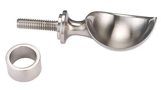

My newlywed niece loves ice cream. So I decided to make her a nice ice cream scoop, using a Hawk Point ice cream scoop kit from Woodcraft. The kit is a definite five stars ... I really don't see how it could be improved upon. The scoop has a striking sculpted shape. Both the scoop and the ferrule are made of heavy stainless steel, nicely machined, and with a lovely brushed finish. All for the princely price of $14. Or even a bit less, if you buy four at a time. I forgot to take a photo of the hardware, so here’s a stock photo from the Woodcraft site.

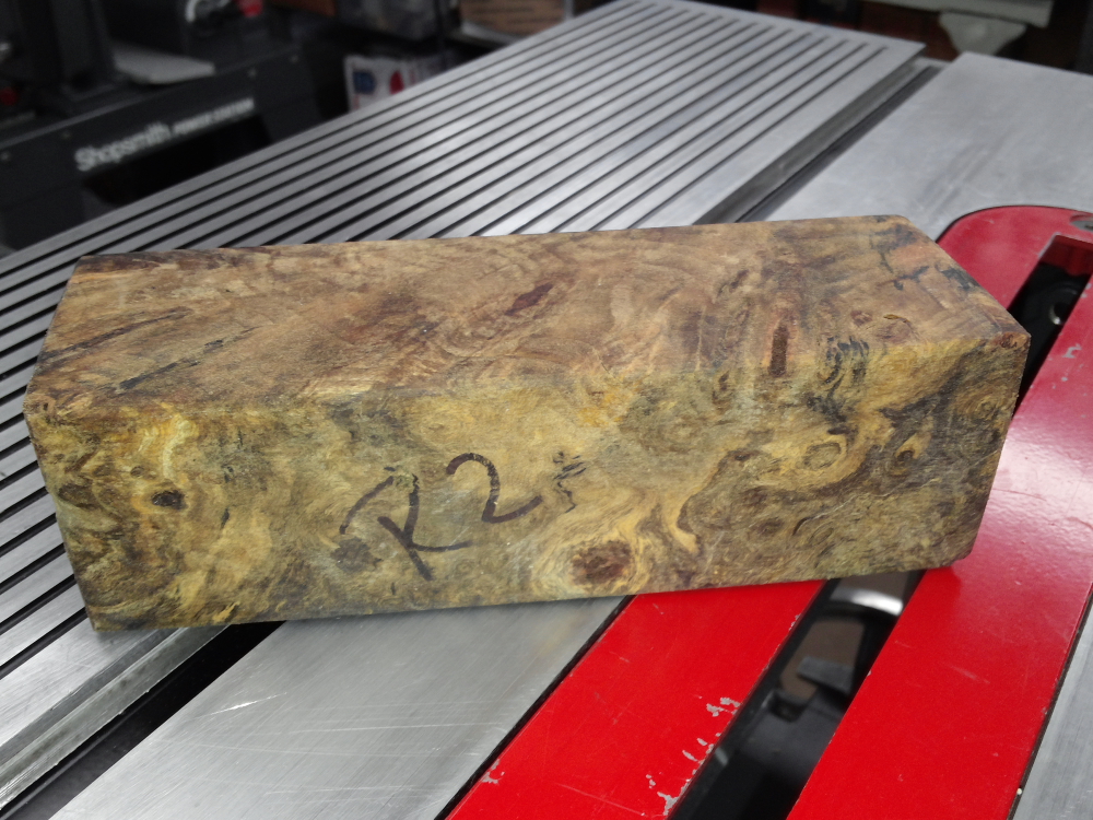

And here’s the burl blank that I started with.
I had never worked with buckeye burl before, and when selecting a blank, I was struck at how light they all were. The low density, combined with small voids and random grain orientation, made me worry that they might not be strong enough for an ice-cream scoop handle. So I decided to bore the blank out almost full length, from the scoop end, and epoxy in a 3/4" oak dowel for reinforcement.

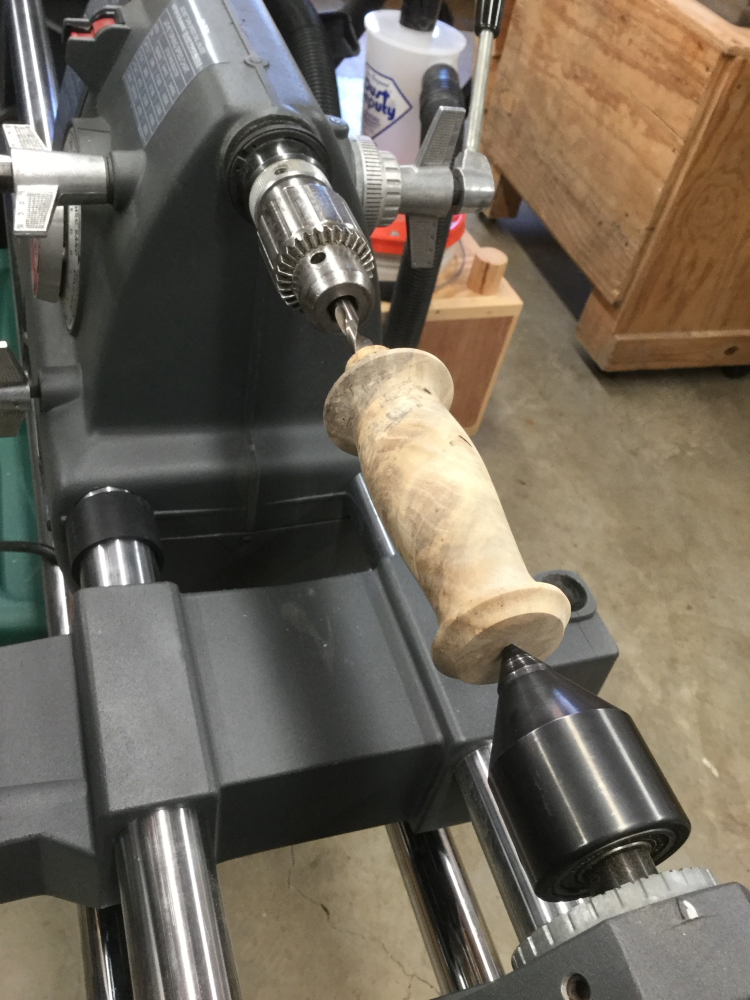

This would be only my fourth turning project, and my novice turning skills were pretty rusty even at that. Plus, this was my first chance to play with my new Nova live center (from last Christmas) and my new Nova G3 chuck (from the last Shopsmith special). So I decided that I should turn a practice handle first, before attempting to turn the buckeye burl.

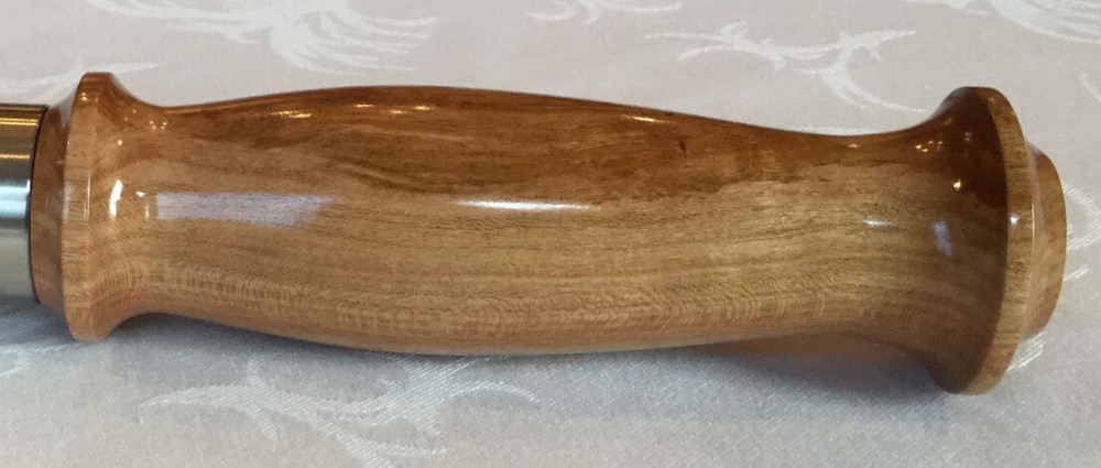

For practice blanks, my available options were ash and cherry, both sawn a couple years ago from trees that had died in my woods. As there was only a couple of days to go before the trip, I decided to use the cherry. I figured that would improve the odds of having at least one pretty handle, in case the buckeye burl blew up on me.
As for the handle profile, a reviewer on the Woodcraft site had posted photos of his scoops, and I thought one of his handles was quite nice. So I modified his design just a bit, and went for an organic vase-like shape. Then I fine-tuned the profile to make it feel comfortable in my hand. Despite a couple of catches with the gouge while turning, the practice handle turned out pretty good. The pic below shows it after three or four coats of wipe-on poly.

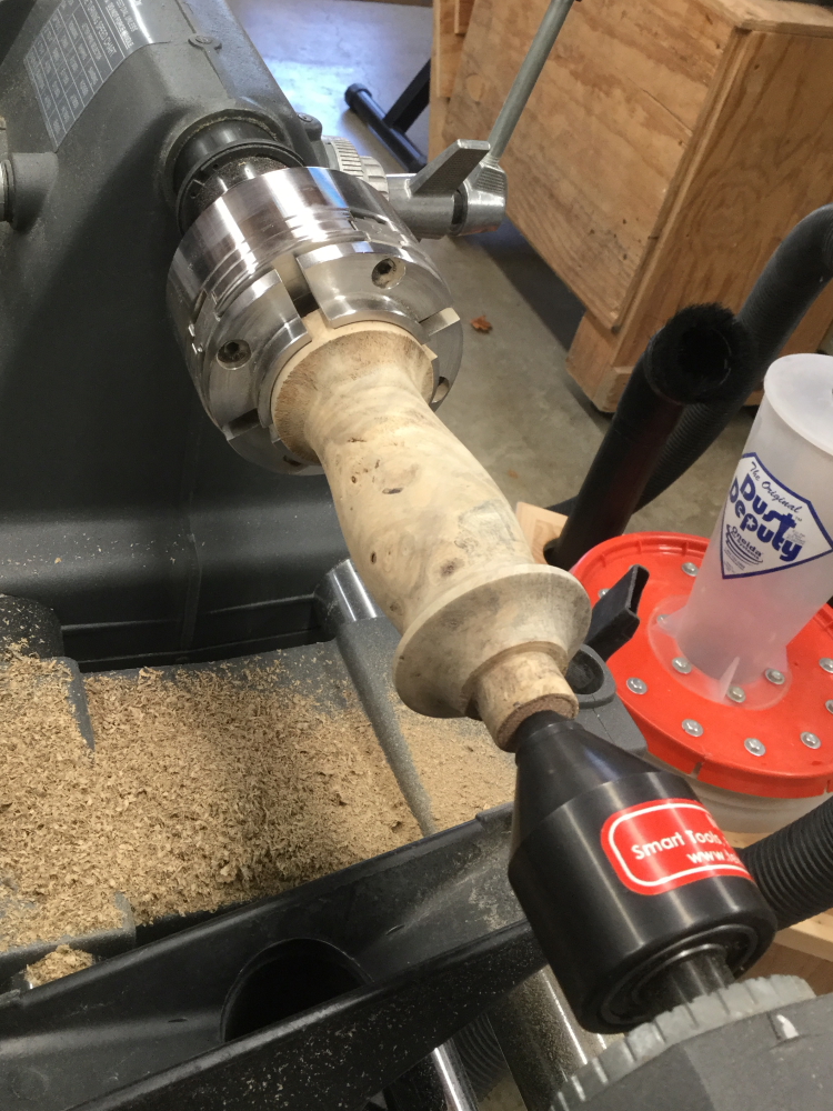

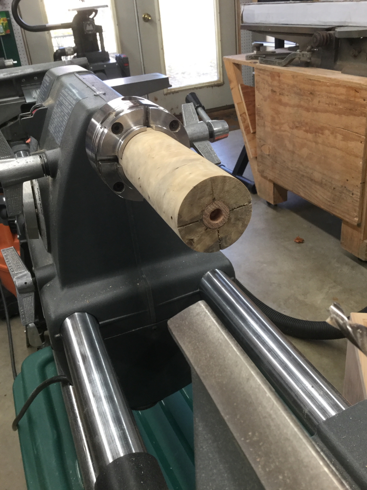

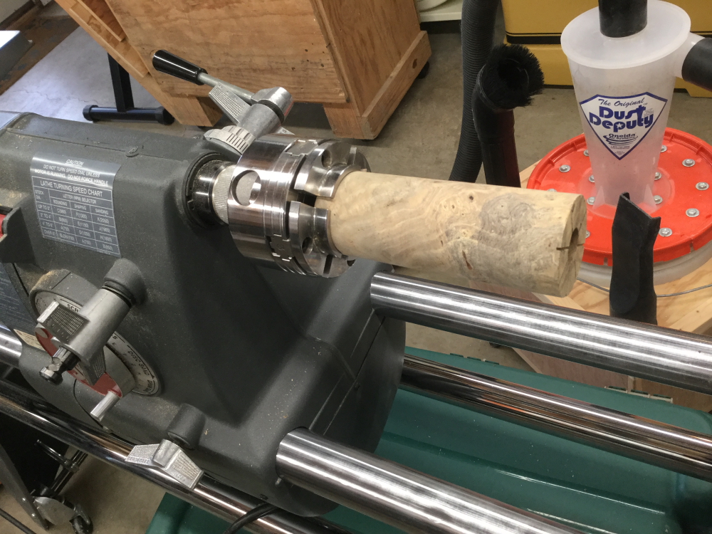

After re-learning how to avoid catches, turning the buckeye blank went surprisingly well. I cut it octagonal on the band saw, and then rough-turned it between the SS drive center and the Nova live center. The photos below show the next steps.
Not shown, to turn the back end of the handle, I removed the 50mm chuck jaws, reversed the workpiece, and chucked directly on the tenon.
The new Nova G3 chuck was terrific for the actual turning. But for finishing, it would have been somewhat in the way. So I simply used a brad-point bit in the scoop-shaft bore as a "jamb chuck" for final sanding and finishing, with the Nova live center still doing the tailstock duty.

As it turned out, my niece chose the buckeye burl, but my sister-in-law really liked the way the cherry handle fit her hand. Cool, instant Christmas present ... additional scoop kits are only $14!

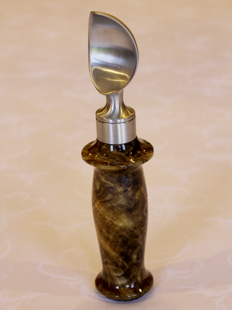

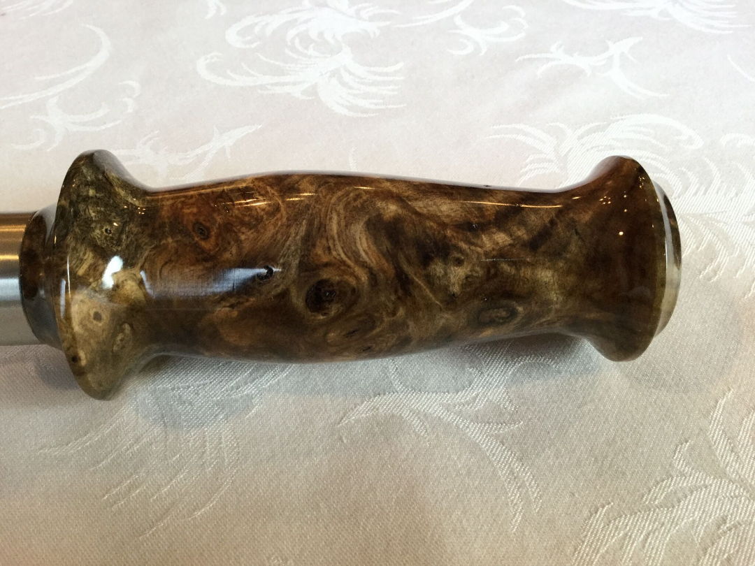

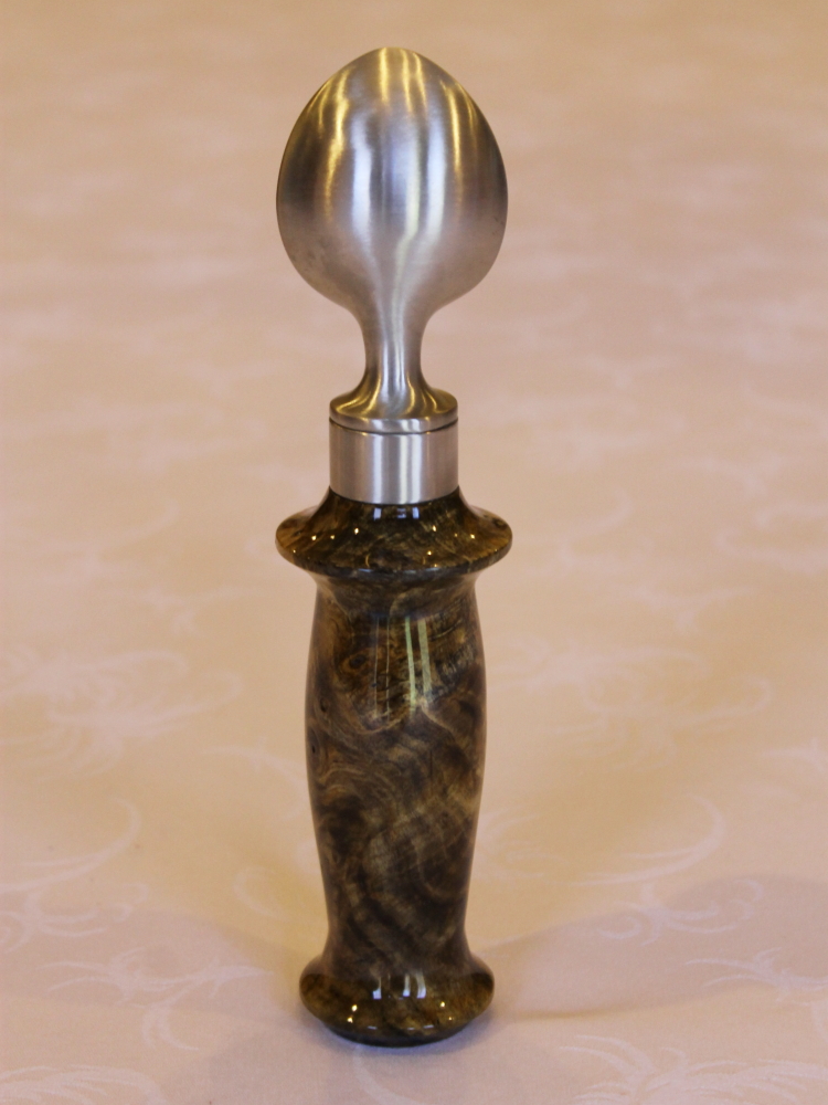

And here are the final results.
Thanks for looking, guys, I hope I gave someone a Christmas-present idea.

ERLover
- Posts: 3914
Re: Buckeye-burl ice cream scoop
NICE, and she will think of you with each scoop!!!!
OMG, that's beautiful! Novice turner? I think not!
That's gorgeous work!
Chris
Chris
Your patience with the finishing really paid off, it's just beautiful. And thanks for the kit review, I think I'll order one, or four.
That is magnificent Dennis!
Very Well Done!
I've made and seen a lot of ice cream scoops Dennis but this is by far the best looking scoop I have ever seen PERIOD.
