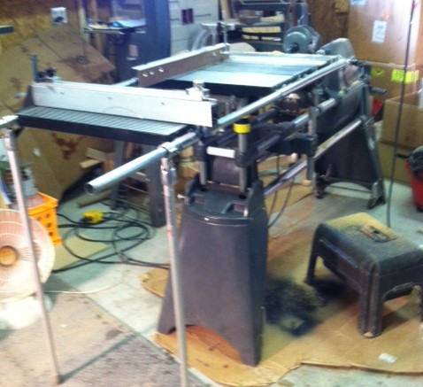

In making a dining room table bench, I forgot to saw tenons on the seat, so I could attach breadboard ends. You all know that breadboard ends need to have mortises that will allow expansion and contraction of the main seat.
After thinking out this issue, I didn't want to shorten the seat and enlarge the breadboards (this would have been the simplest). I figured if I could cut mortises in both the seat and the breadboards, I could make tenons to match.
I wondered how could I cut mortises in the seat. Here is the setup I used. OPR in horizontal mode and an Mark V extension to hold the weight of a 43" long bench that is 1 1/5" thick by 18" wide.
Congrats, Shopsmith, for making a very adaptable machine.
Mark V setup for mortises.JPG (74.8 KiB) Viewed 3499 times
Extension table was used for support and a floating table with the rip fence and the Shopsmith fence stop attachment.

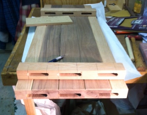

Here are the results:
Bench mortises.JPG (58.58 KiB) Viewed 3499 times
Will show the completed bench when attaching the legs.

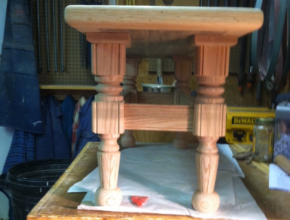

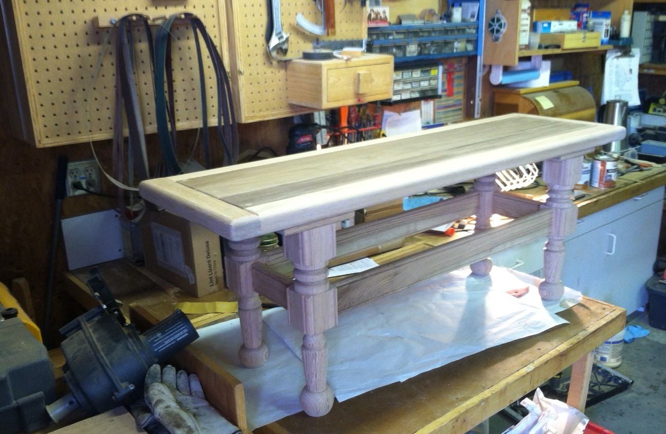

Re: Once more - the Mark V comes through
Thought it would be appropriate to show the assembled bench. No finish yet. Walnut center Oak surrounds and legs.
