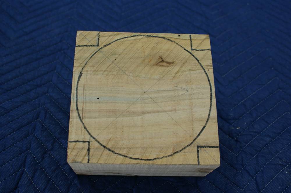

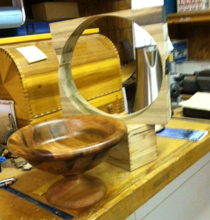

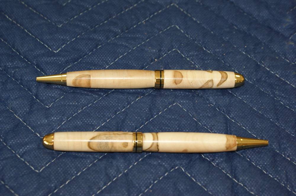

I turned a bowl for my daughter as a Christmas present and after roughing out the blank I realized that some wood could be saved from a larger blank for some other projects.
The ambrosia maple blanks were 6" X 6" X 3" so I cut the corners square and turned the bowl. The corners were 3/4 X 3/4 ".
THE BLANK THE SALVAGED PROJECTS Bill V

It looks like the pen blanks were completely cross-grain. Any challenges with that? The "end results" are beautiful.

Bill, this am when I saw the first pic, I said, pen blanks, and I am not a turner, then I said self, instead of having some arched cut off, wow, have a square, no matter what you use it for.

The cross grain was no problem either when drilling the blank or turning them. I think that when gluing in the brass tube it serves to hold the blank rigid.
Masonsailor;
I just could bring myself to pitch that much figured wood into the scrap can hence the pen blanks.
Bill V
Masonsailor;
