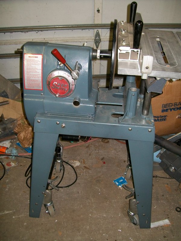

Thanks Bill. You are the master when it comes to thinking outside the box and then actually making something no one else could. I know you've adapted a Mark V headstock to a power station (pictured below). How about adapting a power station speed changer to a 10E lathe? The 10E/ER speed changers are very rare and power stations are ubiquitous.

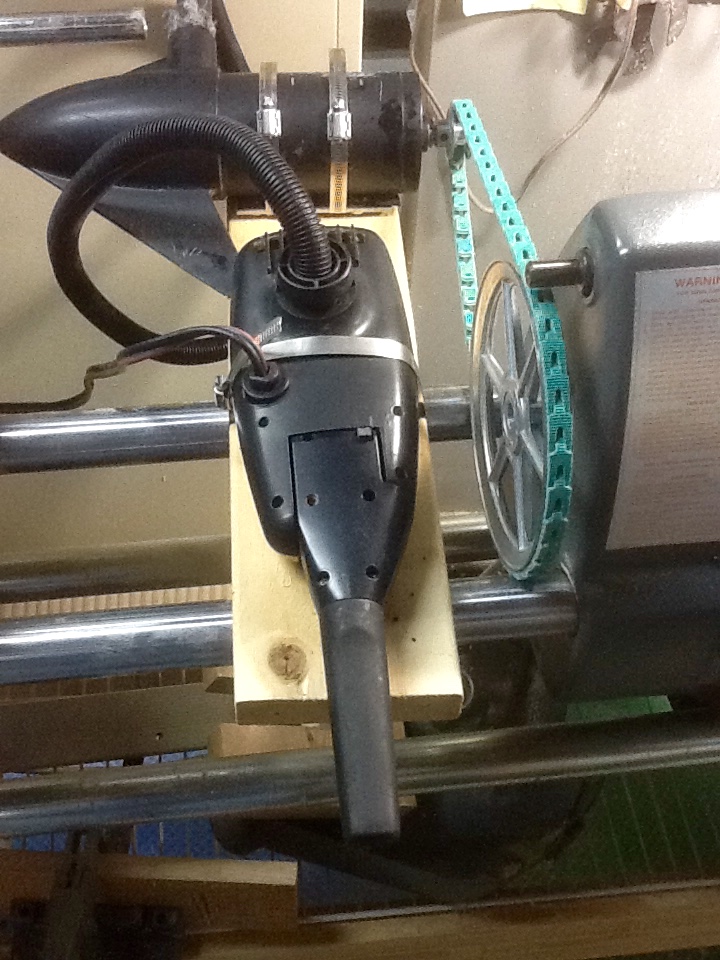

kenbu
Posts: 115
Joined: Sat Jan 24, 2009 10:27 am
Location: Pittsburgh, PA
Re: More crazy talk
Post by kenbu »
Here's the "outboard" setup I use for sanding, finishing and other slow speed work. Reversible, too. It's a small 12v motor, so it's not up to the task of full-time duty.
