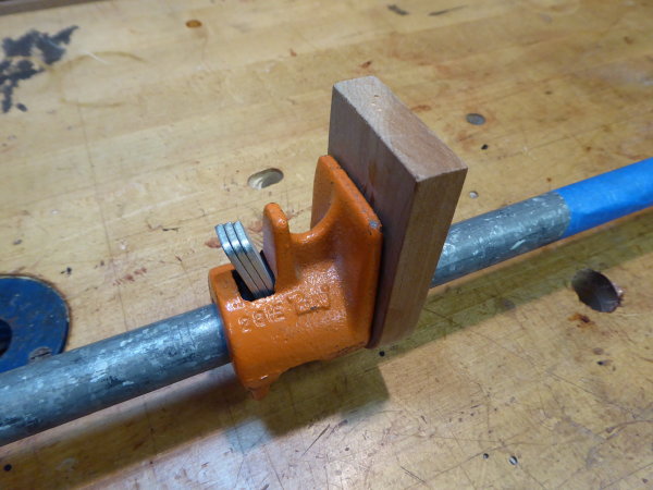

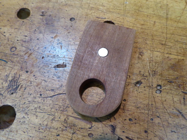

I use a few pipe clamps in my shop. A few years ago I read, in Wood Magazine a tip. It said you could easily made wood pads for pipe clamps and hold them in place with rare earth magnets. So I made them for my clamps. I glued the magnets into place with two part Loctite Epoxy. Three of the glue joints have failed, the magnets, coming out of the socket.
(pics attached) What did I do wrong?

Re: Clamping Pad Issue
Here's some thoughts:
Did you clean the magnet well before gluing?
Are you gluing the sides of the magnet, and not just the back?
The pocket looks a bit oversized, although the epoxy should fill the gap. Does the magnet want a metric-size pocket?
Is the magnet proud of the pad? If so, the clamping forces might lead to glue-joint failure.
You are using a magnet far stronger than was available a few years back?
Glue a thin 'face' over the magnet?
Epoxy does not stick to a smooth chrome plated surface?
Super glue?

I did not clean the magnets before gluing. But I'll try that next time.
The magnets sit slightly proud of the pad.
I'm pretty sure the magnets were Imperial sized, but not certain. I didn't think, and don't understand way, an oversize socket would matter?
I didn't try CA glue - I thought epoxy worked on everything?

I use rare earths alot, I use epoxy, I have had that issue on some applications and some not, I give them a slight buffing with 220 grit and clean with alcohol, seems to work the best. I love those beast.
You have to be very discerning regarding the size. 6 mm does not equal 1/2 inch, but you see them identified as such. Also, proud gives you greater holding force and greater pull out force when removing them.

I have glued in magnets like that with epoxy and they are still in place many years later. I wonder if the bond brakes when you use the clamps, with the magnet proud of the surface that is where the clamping force is going to be located and that being such a smaller area it will be quite concentrated at that point. It might be enough to cause what you are seeing.

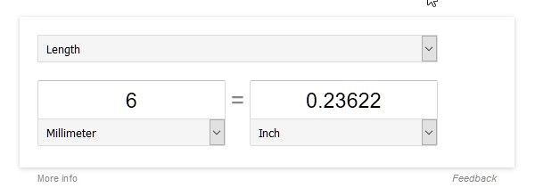

BTW if anyone has problems with metric to imperial measurements or the other way you can google it.
Start typing in something like "6mm=i" and it will have the answer for you:

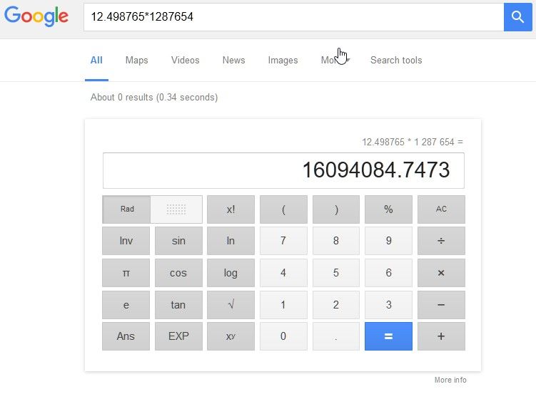

You can also do math:
