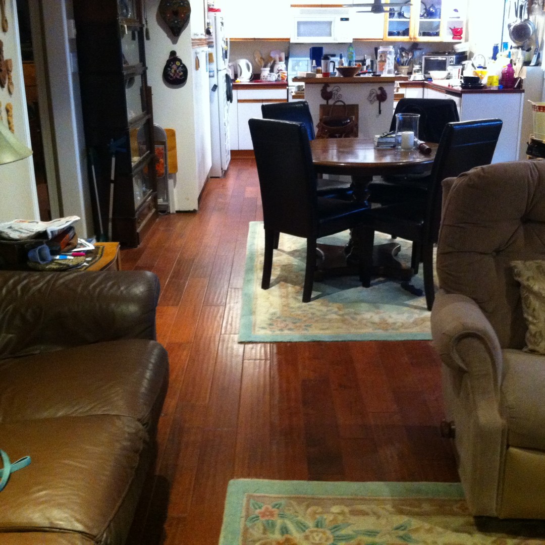

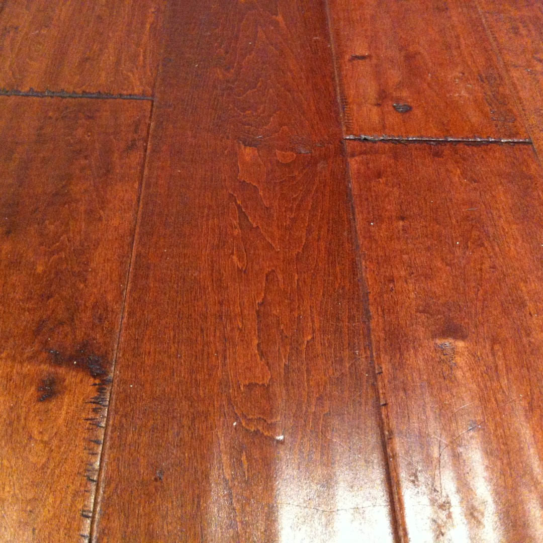

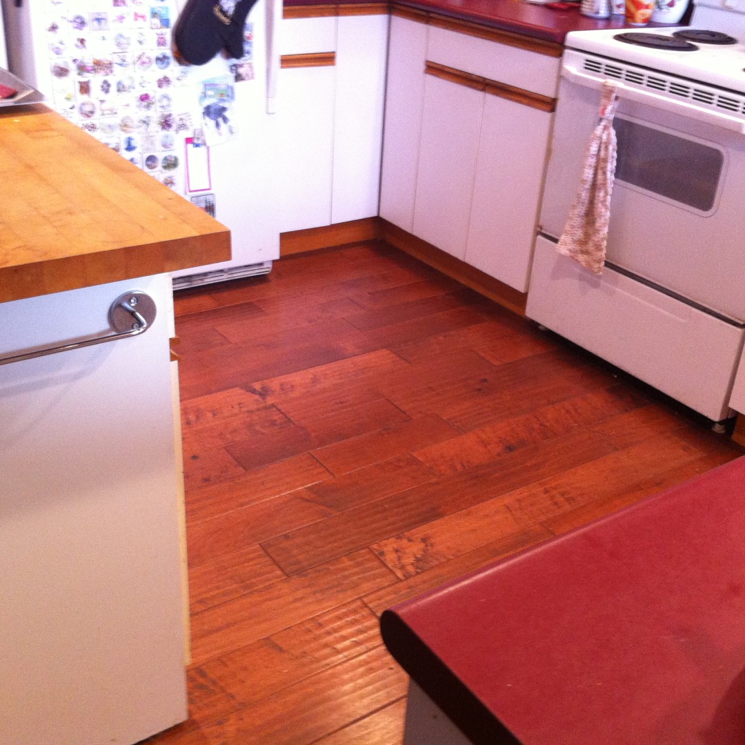

We had our kitchen, dining room, living room renovated about ten years ago. A wall was removed so they became one continuous space.
The flooring is engineered wood, maple, "hand scraped" planks with a gunstock, satin finish
Yes we like it and would do it again.
No problems with water damage, in the hall we have had some minor flooding on a few occasions, plumbing leaks in laundry room and bathroom, that got under the flooring but has not caused any problems.
There has been a few scratches (thought the finish) and quite a few marks where the wood is marked but the finish is intact, some of these are visible in the close up (third photo).
They don't really show however due to the hand scraped surface and low gloss finish.
Care is easy, just dry mop or damp mop with a microfiber mop.
