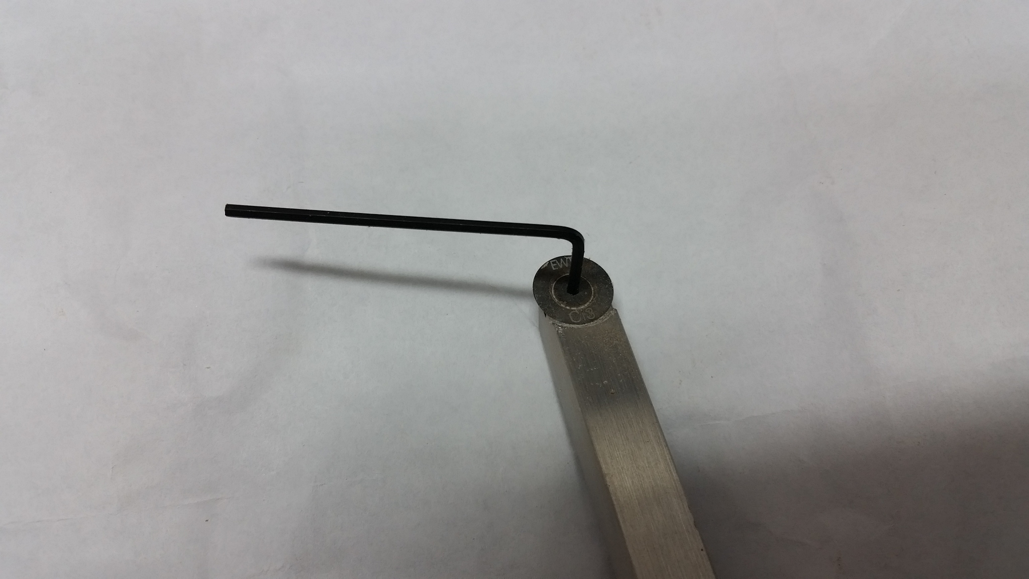

Re: Making your on lathe tools
I'm out in the shop using my phone to post this
This is the tool set that has the smaller wrenches.
2016-02-12 16.35.03.jpg (1.04 MiB) Viewed 7352 times
2016-02-12 16.37.25.jpg (515.59 KiB) Viewed 7352 times
Yes the 1/16" is correct.
