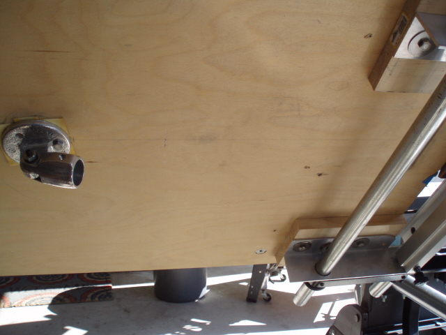

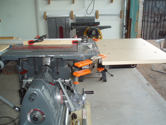

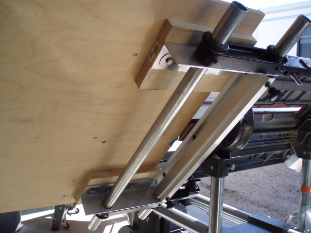

Infeed/Outfeed Table
Well, much to my surprise, my ideas about a cantilevered outfeed table worked. What was really satisfying was that the modifications didn't alter the useability of my original table.
I can use it with or without the special support leg.
Both images show the Extension Table Bracket and how it is mounted. This bracket enables the outfeed table without the use of the Support Leg. The second photos highlights the fact that even without the Support Leg the outfeed table retains its position.
- With Extension Table Bracket.JPG (141.71 KiB) Viewed 7132 times
- Without Support Leg.JPG (138.11 KiB) Viewed 7098 times

What purpose does the extension table brackets serve?
From the Saw dust session this morning it looks like could just mounted your table to the SS by passing the table support tube through the hole you made in you aluminum L bracket.
All you need is something to hold the table to the main table right there is not need to try to support it fully on the extension brackets is there?
I haven't seen SS outfeed table other than this morning in the Sawdust session but it looks like a simply bracket bolted to the table with a hole large enough for the support tube to pass through. It then acts like a hinge letting holding the table in plane but allowing it to swing up and down. Or am I missing something?
Answered below.
The extension Brackets ARE the support to hold the extension to the main table.
I did not get up early enough to see the Saturday Saw' Session, but with the extension brackets, you won't need another bracket or a hole in the main table. The extension brackets serve that purpose (along with Dusty's "L" bracket.) Use of the extension bracket ties in both possible rotation points (the two tubes) with the bottom of the main table. The brackets are strong enough to hold the extension table level with the main table, and also will allow vertical adjustment. Dusty's discovery is BRILLIANT!
Answered below.
