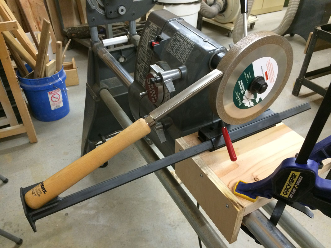

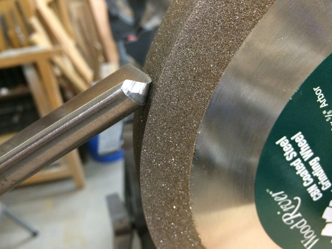

The Oneway Wolverine Grinding Jig teamed up with a Shopsmith and a Woodriver CBN grinding wheel makes a fine slow speed grinder for lathe chisels. The wheel has a 5/8" hole and mounts using the Shopsmith 5/8" dado arbor. The CBN wheel is perfectly balanced right out of the box, never needs dressing and is made out of solid steel so it will never break apart. Slide out the jig arm to match the bevel, clamp it down, then simply rotate the gouge back and forth. It takes just a few seconds for a great edge.

Slick! What is the grit of that CBN wheel?

Cubic Boron Nitride (CBN) abrasive

Thanks guys, I'm pretty excited about it too. The wheel is 120 grit. I need a lower grit too and I would like a higher grit also! But I'm just taking it slow for now.

you can make one or buy one - Cap'n Eddie Castelin Big Guy Productions
http://eddiecastelin.com/cutters_only
he has plan to build a sharpen jig, He calls is the International Blackhawk sharpen Jig
Look at his Sharing Information page and you will find the pdf for it.
YouTube showing it is http://eddiecastelin.com/yahoo_site_adm ... 123330.pdf
He also shows how to sharpen chisels on the belt sander
https://www.youtube.com/watch?v=aaqIGVmVHY8
I bought a 600 grit belt sander belt from a local machine supply company.
I first used 120 grit to get the shape on the chisel, then used the 600 grit to do the final sharpening. Puts a nice edge on the chisel

For those who may not want to spend the money for a Wolverine Jig, I posted this back in Jan. 08. It's a build your own Wolverine Knock Off jig...

Very innovative approach!!! I am not one of those who favors lathe mounted sharpening systems. The tools will need sharpening during the turning and I dislike dismounting the turning to touch up the chisels. But those folks with stand alone lathes will like the idea I am sure.
