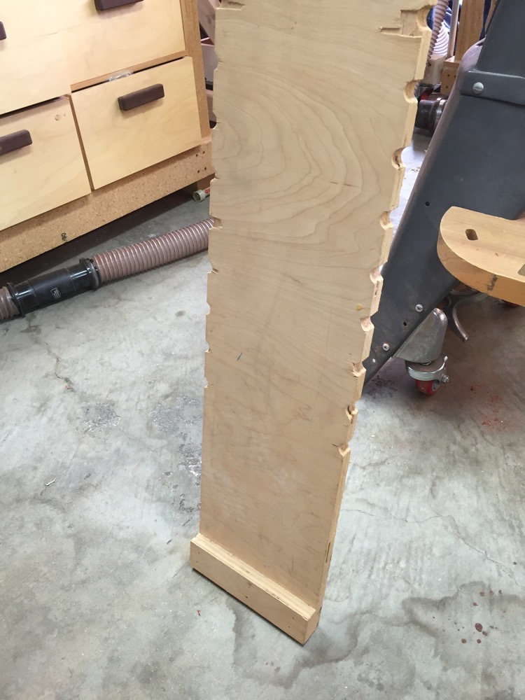

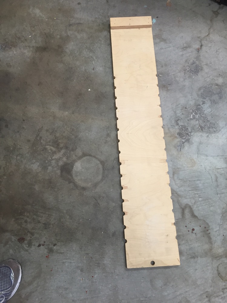

Ed do you have a plunge router ? There is a much better and easier way to do shelf pins using a plunge router. I am not home at the moment but will be later and post a picture. Very simple to make and makes very fast and accurate shelf pin holes.

Here are the pics of my shelf pin template. This one happens to be for a tall upper cabinet but I have them for all cabinet configuration. They are simple and quick with high accuracy. Just drill the holes on center for your template bushing and then run it through the saw to open up the holes. The router will give very crisp holes and it is repeatable from one side of a cabinet to the other with absolute accuracy.
Paul
