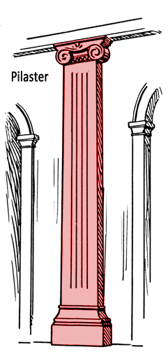

Gosh Ed, It seems your definition of pilaster is different than mine. When I think of a pilaster, it is a hollow column used to look like a full column against a wall, or a hollow column of bricks/blocks used at the end of a wall. Mostly decorative - not weight bearing.
Can you show us a picture of what you need?
I am thinking that any hollow column of wood will be able to support many pounds. Seems the limiting weight factor to a book shelf would be the shelf itself.

http://www.merriam-webster.com/dictionary/pilaster
Merriam‑Webster
Full Definition of pilaster. : an upright architectural member that is rectangular in plan and is structurally a pier but architecturally treated as a column and that usually projects a third of its width or less from the wall.
