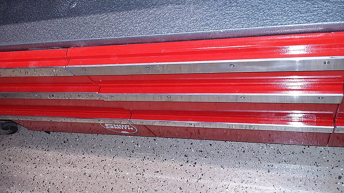

Here is a close up of the pulls, which are made out of 1" x 1/8" aluminum strips, polished and attached using Stainless Steel screws to prevent Galvanic corrosion to 3/8" x 3/4" stand-offs.

To protect the cabinet edges and the Shopsmith legs, I added UHMW rub strips to help guide it in place with out scratching anything.
All in all I say they turned out pretty nice, if I do say so my self.
