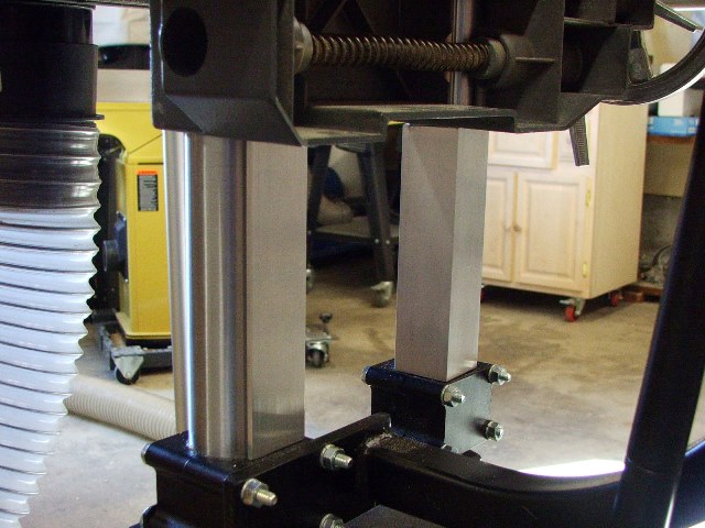

I use the telescoping legs to support the front of the table and I cut two pieces of aluminum angle to support the table carriage.

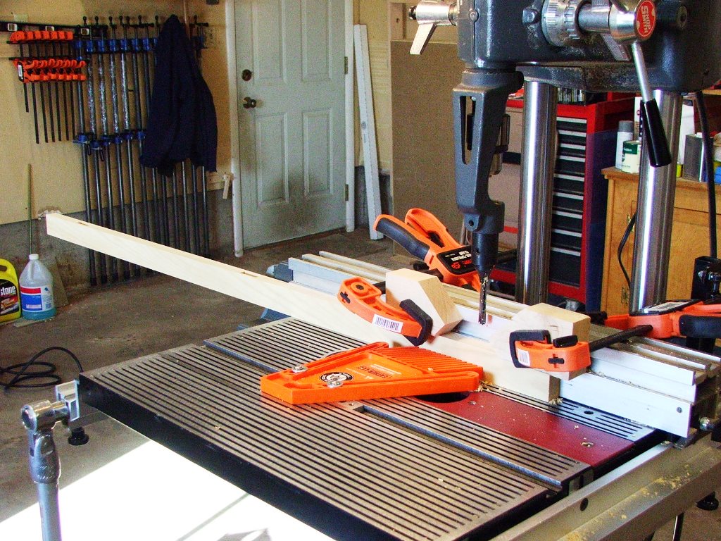

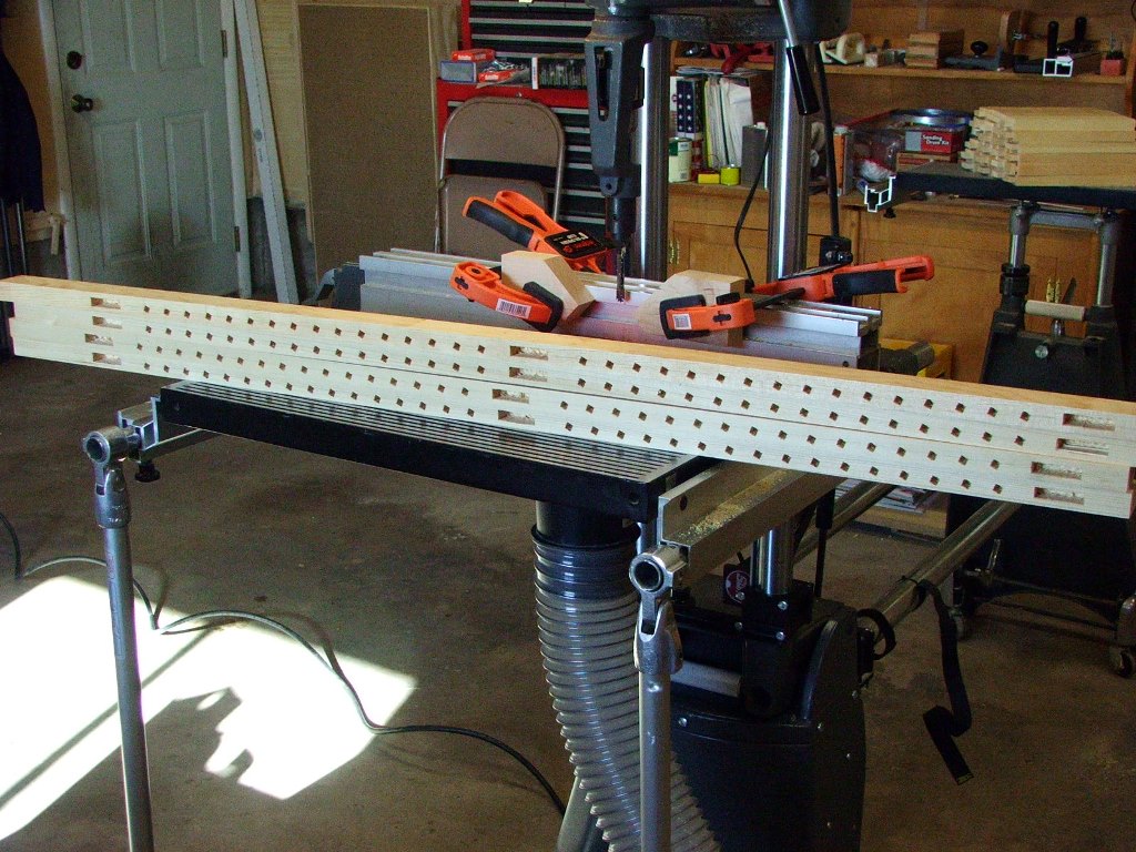

I made a set of shutters for a friend at work. These were inside shutters for two 4'X4' windows. It ended up with 256 louvers for the 8 panels and over 1000 mortise cuts just for the louvers. The wood was clear white pine. The louvers were quarter sawn 1 1/2 X 1/4. The tenons on the louvers are 1/4 X 1/2. The picture of the stiles only shows one cut for the mortise for the louvers. I moved the fence and did it again.
The point is that the SS in mortising mode works. Is it a Powermatic dedicated mortiser hog? No but it works. Sharp bits are the key as that is in any wood working project.
