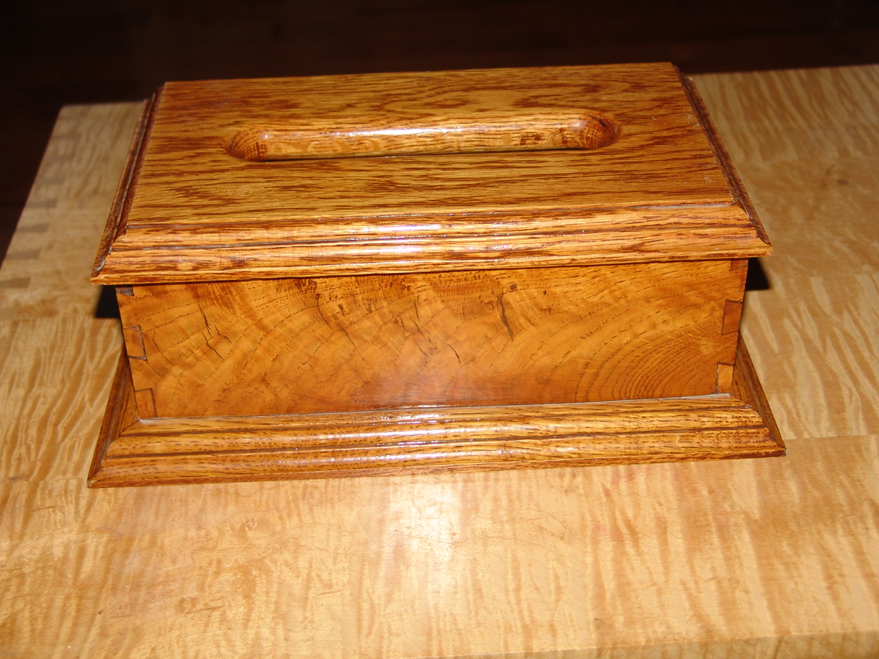

Here is a pic of two items I made from solid wood that I got from a bulk wood purchase at different times.
This is Flame/tiger white Oak and Curly/Quilted/Fiddleback maple all in several pieces of the table top.

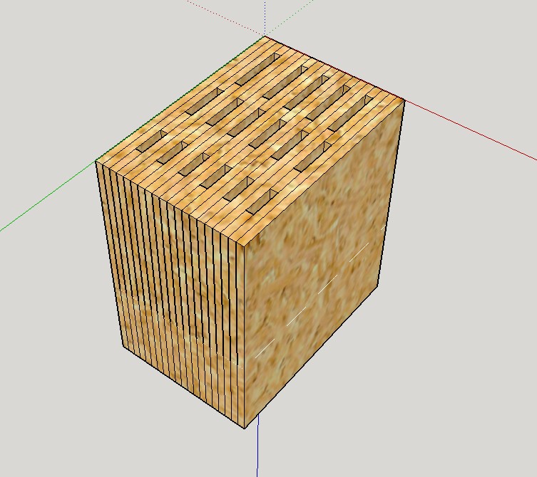

A whole knife block would not take much wood so I think you would be better off picking what wood you want and make it out of a solid block of that wood. If you wanted to make life easier cutting the wood into thin strips and gluing up to get the knife spaces would be pretty easy and then if you want special wood on the outer most sides it would not be a problem. Sort of like this:

Anyway just a thought I had after reading your post.

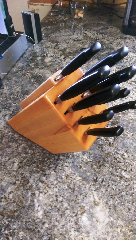

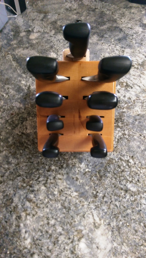

I made one a few years using exactly that technique. There are four rows of knives so I took five pieces. The knife slots were cut in one side of each piece on the router table. The piece on the back was added later when I bought a matching bread knife. It is made from solid hard maple.
