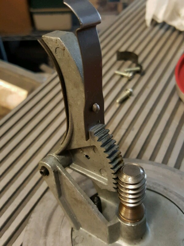

I followed JPGs advice and checked the speed control with the belt off the motor. The speed controller moved smoothly throughout the ranges. I also disassembled the speed controller and I see no damage. After reassembly, I reset the speed controller as described by Jacob's Youtube video. I did notice my saw ran longer when starting with the speed set to the middle range. It still trips the circuit. I think I need to:
1. Disassemble the motor and pulley. See if the motor is somehow dirty or defective.
2. Double check my circuit to see if there's a bad outlet, wire or breaker.
