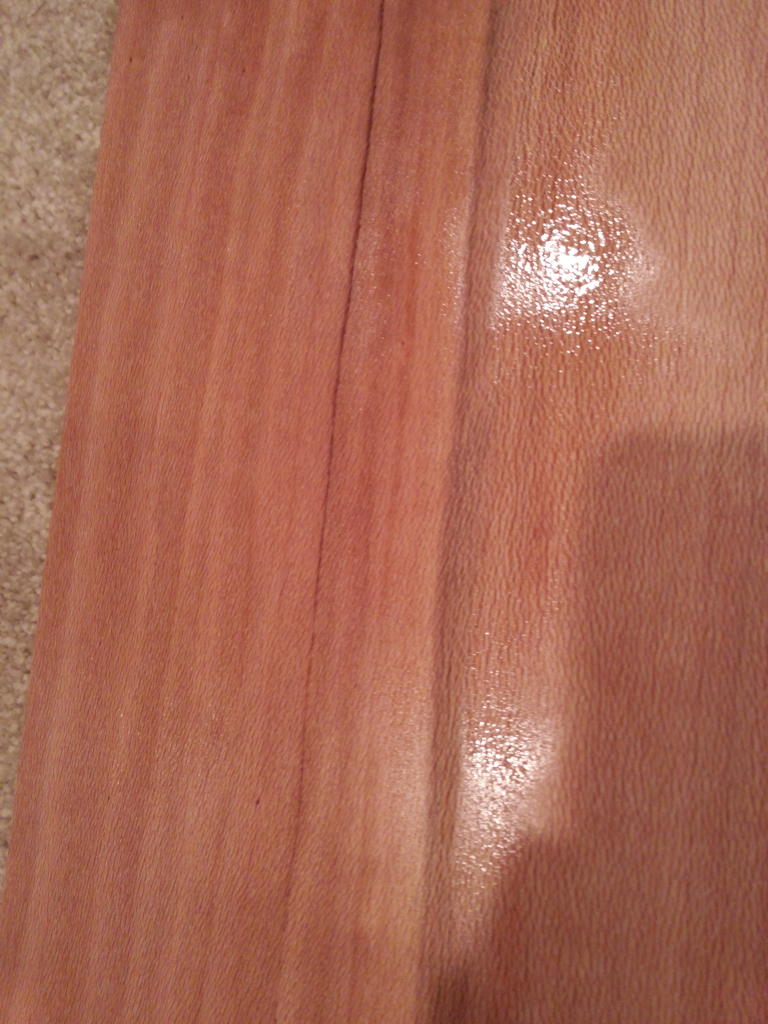

But I ran into a small problem with the sycamore lumber. The widest boards are 7", and several of those have developed cracks in their midsections. Below is a photo showing one of the cracks -- I spritzed the board with denatured alcohol to simulate a clear finish for the photo.
So now I'm wondering if I should try to fill the cracks, or just let them be. I'm concerned that a glue/sawdust filler would make the finish blotchy. Any ideas out there?

That crack in sapwood?

BD, I think I would just leave them, wood character. I get the impression that it has an aged look to the room, if so, character, if you want a perfect room then fill them but they may crack more later, I bet they were not dry enough to start with.

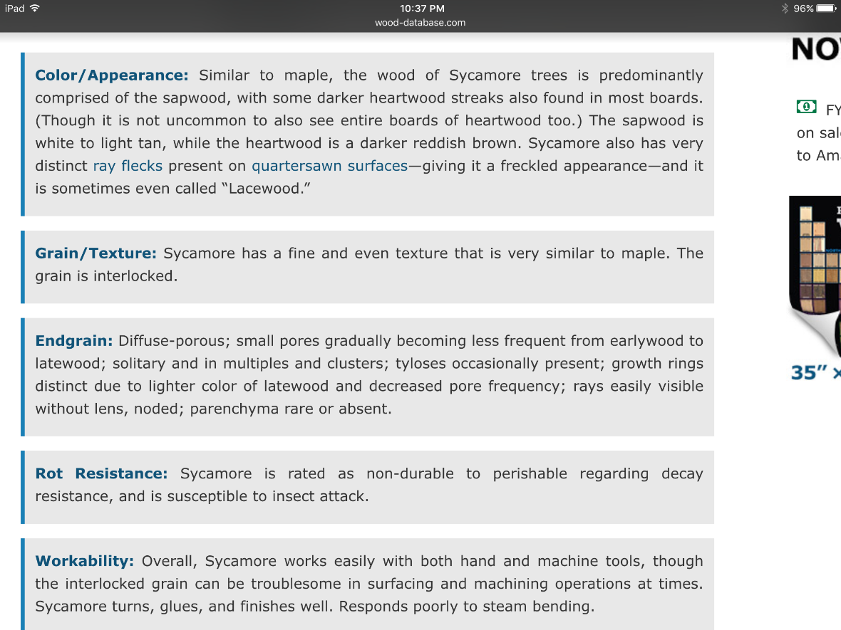

It must be. I've never worked with Sycamore before, but here's what wood-database.com has to say about that.

Have you moisture tested them? My gut feeling is they are still drying and if so you might not want to do any thing with them until they are dry. Ones that crack might need to be ripped smaller and put back together. If wet and you do the T&G and put together it can shrink a lot and leave some really big openings.

I guess I was thinking it was cracking on you now, but more likely you are saying it came that way........ right?

I'm not sure. I didn't notice the cracks when I picked up the lumber. We stacked it on my trailer pretty fast, carrying small stacks. Then it lived in my garage for a couple weeks, and could have picked up a little humidity before my son and I carried it inside to acclimate. The cracks are not nearly as noticible when dry, so I may have just missed them.

What's wrong with ripping the boards along the cracks. If you did that you would have solid boards of varying width. A good look in my mind.
