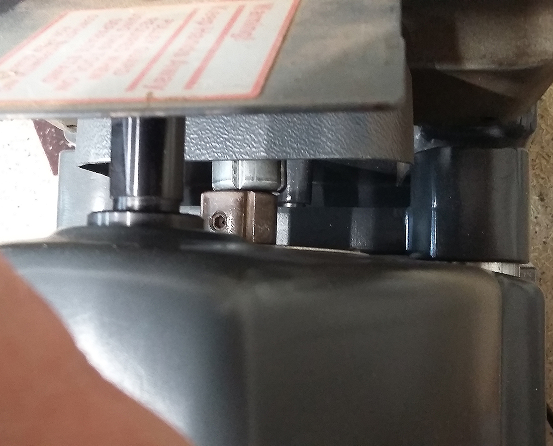

I found out the shaft on the jointer was bent, about .0020, so after some careful tweaking I got it back straight, negligible bend. I also note that the couplers do not line up horizontally, I got the vertical spot on, but the side to side is off a good 1/8" and there is no adjustment that I am aware of to bring this in to alignment. See Picture.
Mis alignment.jpg (566.77 KiB) Viewed 2912 times
Any thoughts on this or am I missing something simple. I seem to remember the same alignment on my first jointer.

The bearing mount has large holes which provides some adjustment.
If insufficient, the SS base(end casting) can be rotated about a vertical axis on the bench tubes(loosen the two cap screws holding the bar clamp).
I do not recommend adjusting the tie bar stop set screw for this.
Far easier however is to use the eccentric mounting tubes.

JPG wrote:The bearing mount has large holes which provides some adjustment.
After some search, I found as you suggested, the use of eccentric mounting tubes made just for jointer. When this was new, it is a Greenie jointer, they didn't offer the eccentric tubes. So I guess exact alignment wasn't a big issue.
There were not so many 'other' SPTs to accommodate. None of the existing had eccentric tubes. They are a SS Inc. thing.
