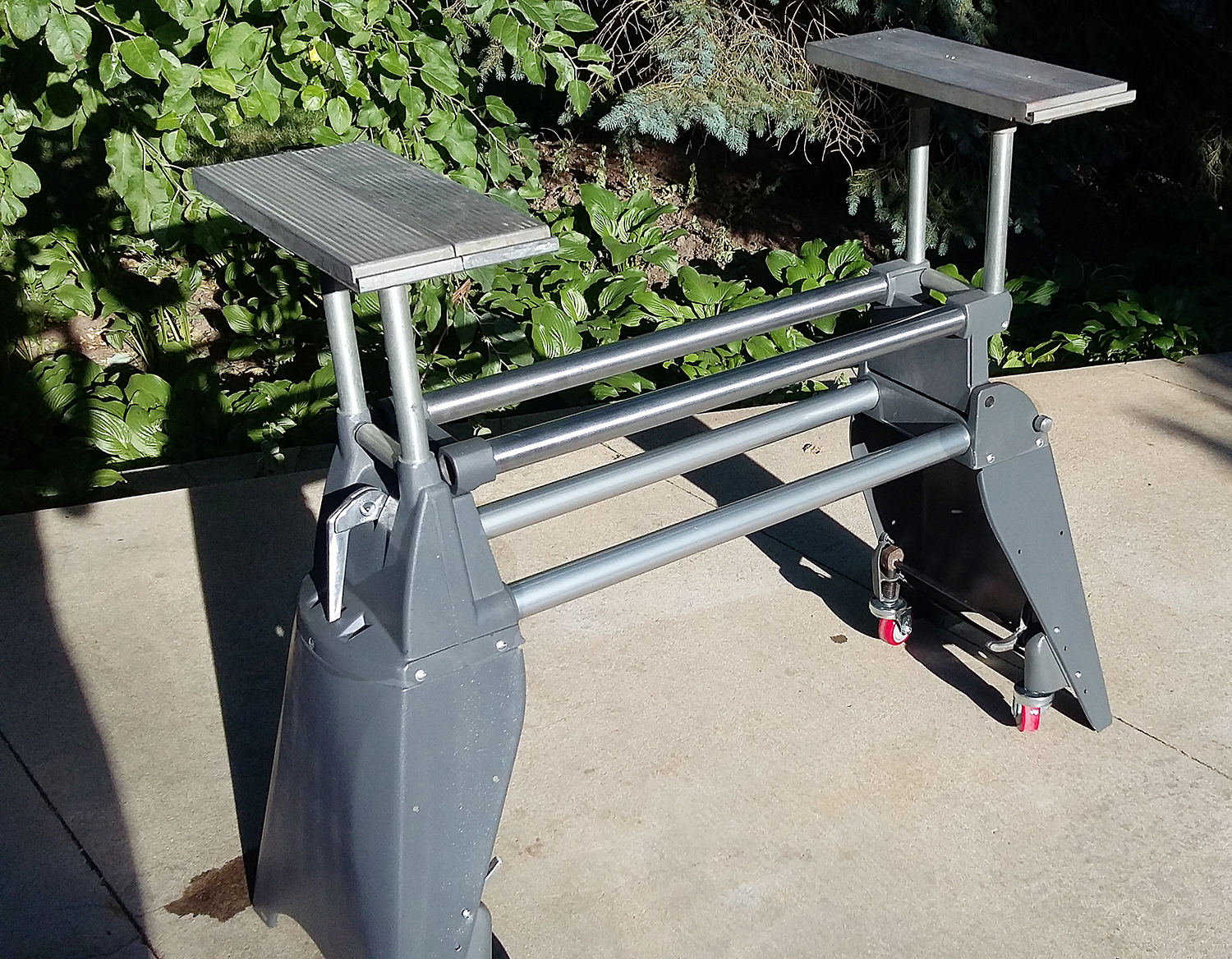

Those appear to me to be Main Table Legs (probably left overs from a double tilt modification). This is real neat application for stabilizing the outer edge of the table while drilling (makes for a very stable drill press table).
I use those same legs with adjustable stop collars for all sorts of applications. One frequent use is to stabilize the table when table tilt lock seems unreliable or tilt angle needs to been "finely tuned" to a specific tilt angle.
Re: Building a Shorty
They support the front of the table. They eliminate all flex. You could sit on the table and it will not move.jjbuzard wrote:Jsburger, what are the 2 verticle tubes in the picture of your dedicated drill press for, looks like a wooden dowel joining them at the top.jsburger wrote:
I cut 18" off to make my shorty. It works fine and I use it mostly as a sanding station. I used the left over 18" pieces of bench tubes to make my dedicated drill press.
They are the main table legs left over from a double tilt upgrade I did to my full size machine. They each have a 1/4" hole in the end that accepts a steel pin to attach them to the table. There is no way to raise both tubes and tighten the lock unless you have three hands. Hence the dowel. Raise both tubes up against the bottom of the table with one hand and tighten the lock with the other.

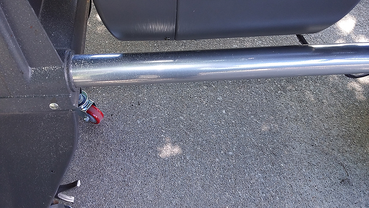

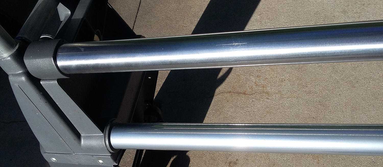

Sorry I haven't posted some health issues kept me out of the shop for the last week or so, finally back at it, got the Shorty Bench Tubes back from powder coat, had these done in Chrome Powder, the pictures don't do the finish justice. They look amazing in person, hopefully will get the final Soda Blast done tomorrow and on to primer and paint.
Bench Tube in Chrome Powder Coat.

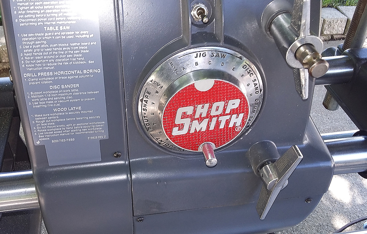

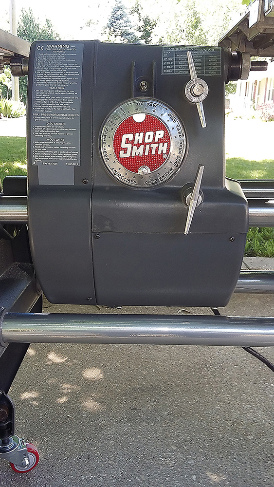

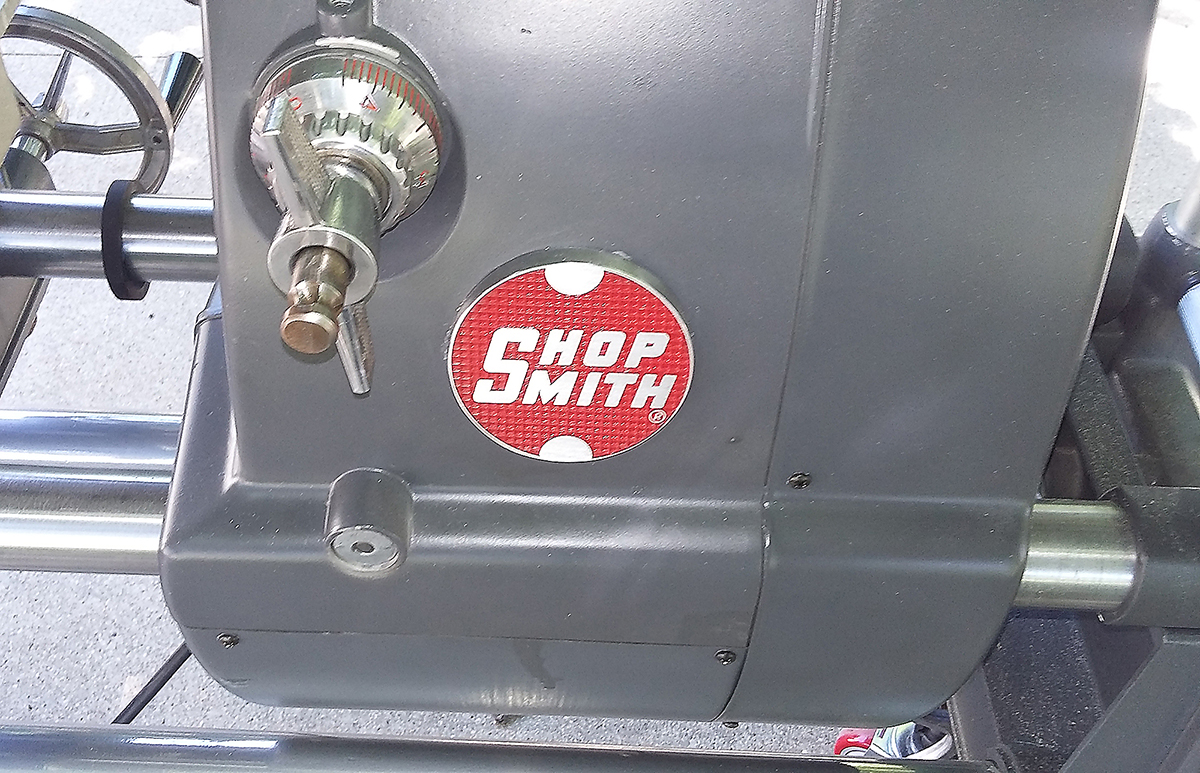

Well the Shorty is done, the safety labels came today, that was the last thing I was waiting for. Now to put it on ebay.
That really looks great!
Ya gonna confuse some folks with the table raising knob.
