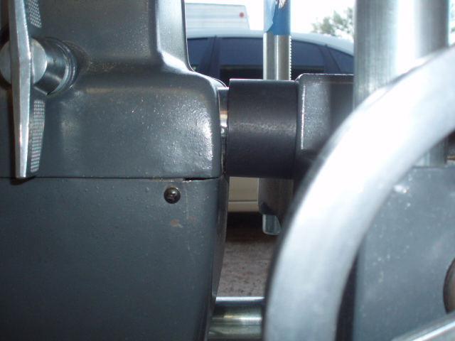

At the same time I ordered my Double Tilt Upgrade kit, I ordered two Carriage Stop Rings (aka, rubber baby bumpers). The one that I had has gotten sort of stiff and I decided to put in a new one. I, in fact, ordered and installed two stop rings rather than one.
It is my opinion that the "primary" purpose of this Carriage Stop Ring is to position and re-position the Carriage in the same position with respect to the headstock each time either is moved. At the same time, I contend that the saw blade should be positioned in the "center" of the table cutout; it has done that on my two machines in the past. With these two new stop rings, the blade is offset approximately 1/8" to the right of where it had been. This is within the table insert but what I consider a long way from "center".
I have approached Shopsmith Customer Service about this and am awaiting their response. I contend that that part 516667 is unintentionally wider than it was. Measurements of new and old confirm this. The question is whether Shopsmith believes this to be an issue or not.

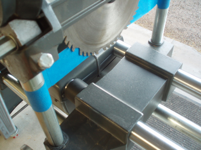

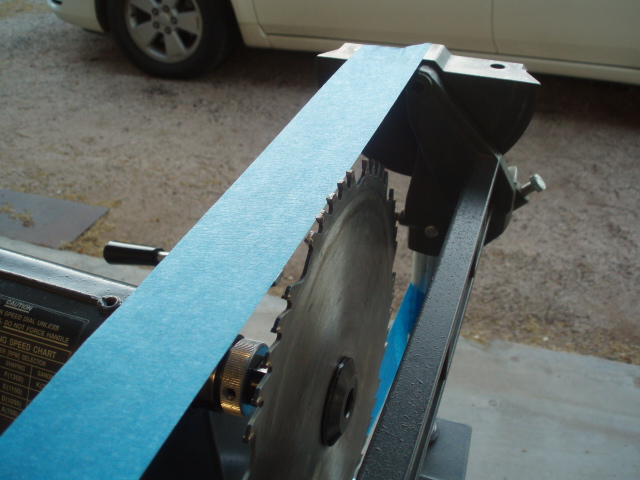

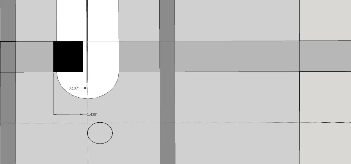

The images that are posted here will tell my entire story. In doing this, I have learned a couple more things about the Mark V.
1. The left hand edge of the Main Table Support Legs are in the same vertical plane as the left side of a thin kerf saw blade. 2. The Main Table pivot line is also the on the same vertical plane as the left side of the saw blade. The width of the Carriage Stop Ring is critical in establishing these relationships as it determines Carriage Location with respect to the Headstock (the blade). Of course, the length of the saw arbor plays into this analysis but one uses only those arbors specifically designed for the Mark V then there should be no issue. You may not be able to see it well in this image but notice the small nib on the side of the headstock that engages the stop ring. I have also done a sketch the details this arrangement.
I have a carriage stop ring that works for me and I am going to use it. In the meantime, I shall find a way to reduce the width of the two new stop rings that Shopsmith sent me.
- The Cut Line and the Stop Ring.png (27.39 KiB) Viewed 8361 times
