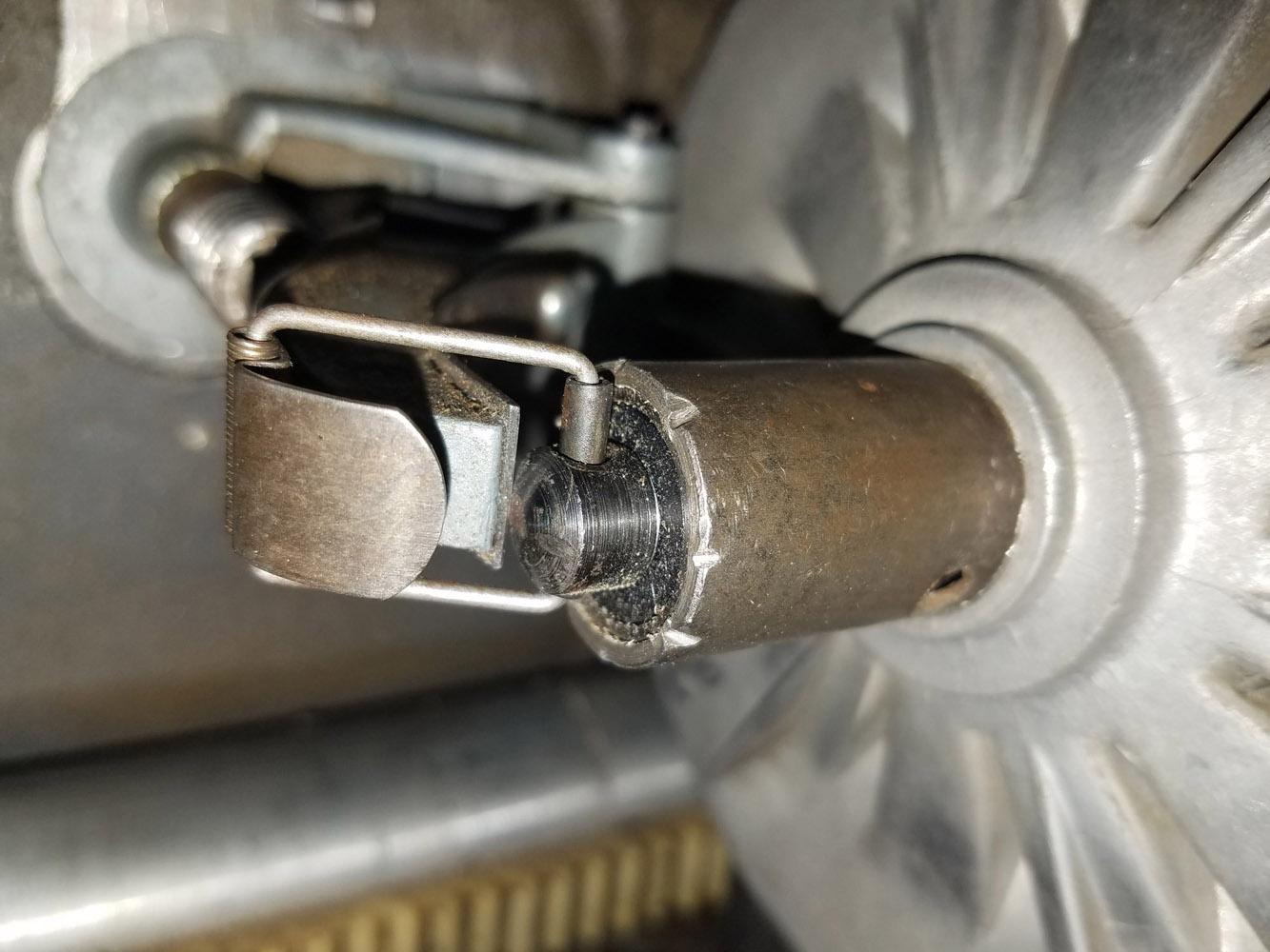

Ok, here are a few pictures. The original owner made some annotations on the parts manual that seem to be relevant to this, so I took a picture of that too in case it has meaning to you guys. Let me know if you need more/different pictures.
Posts: 34643
Re: Shopsmith Mark VII with Mark V speed control
Interesting! How about a pix of the 'operator' side.
Not perfect alignment, but appears functional.
I am curious why the fan sheave note. They essentially last forever.

Here is a picture of my Mark VII from the operator's side. Let me know if you need any others!
Posts: 34643
WOW! That really looks good!
I never realized the round dial area was so close to equal on both models.
BTW the 'clutch' knob is a lever knob that was popular on electronic stuff 'back then'. The cam can possibly be fabricated. Fortunately you have the 'bushing' that the cam shaft mounts into on the belt cover.
Also the traverse gear rack looks very good.
Take good care of the power switch.
Take the second key(the 'YPP' ones) and store it in a safe place. Better yet get a copy and store both originals.
Nice find!

JPG I can envision some new appendices for the Mark VII operator manual I have begun restoring based on this information.
That is a game changer for many I am sure.
I wonder about the control sheave proximity to the mechanism, and how far out the Pork Chop is riding on the button, which may be a function of how it is adjusted, but Wow!
