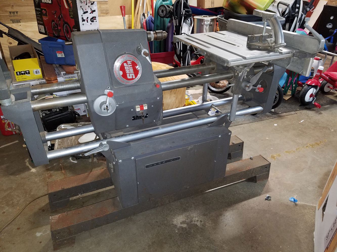

Here is a picture of my Mark VII from the operator's side. Let me know if you need any others!
Re: Shopsmith Mark VII with Mark V speed control
Posted: Wed Jun 29, 2016 10:55 am
by JPG
WOW! That really looks good!
I never realized the round dial area was so close to equal on both models.
BTW the 'clutch' knob is a lever knob that was popular on electronic stuff 'back then'. The cam can possibly be fabricated. Fortunately you have the 'bushing' that the cam shaft mounts into on the belt cover.
Also the traverse gear rack looks very good.
Take good care of the power switch.
Take the second key(the 'YPP' ones) and store it in a safe place. Better yet get a copy and store both originals.
Nice find!
