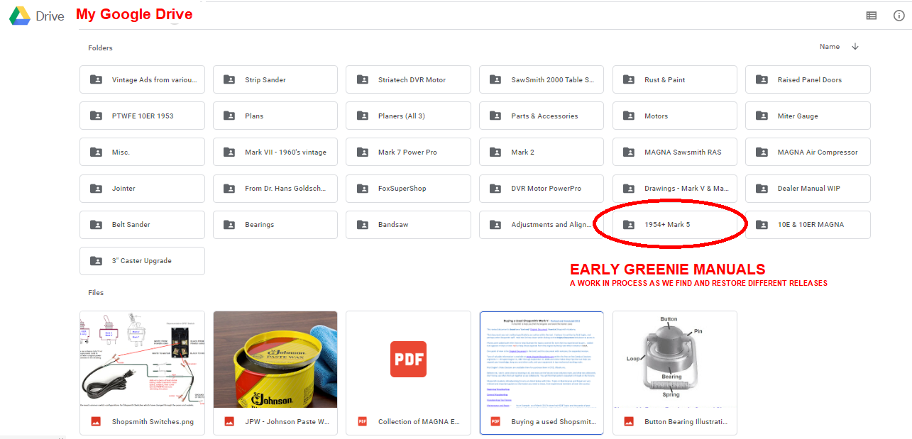

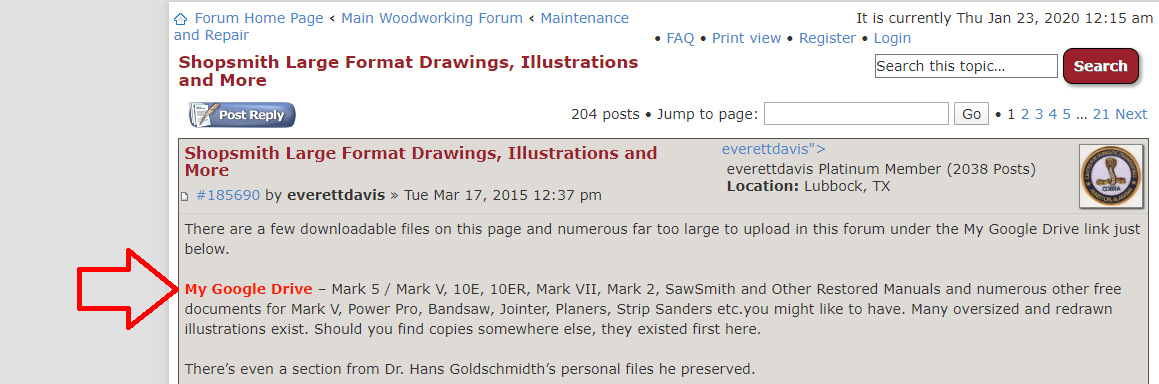

Go to post titled: Shopsmith Large Format Drawings, Illustrations and More
at https://www.shopsmith.com/ss_forum/view ... 90#p185690
Follow the ‘My Google Drive Link’ illustrated below
Shopsmith Large Format Drawings Illustrations and More.png (57.58 KiB) Viewed 26648 times
Files are in Folders:
There are numerous documents manuals and other material, with document restorations, some with enhanced photos, and word search capable, with active tables of contents. All free and donated to the Worldwide Shopsmith Community.
There’s even a section I personally scanned from Dr. Hans Goldschmidt’s personal files that he felt should be preserved. They stayed in a closet in Dayton for over 30 years until I scanned them in 2018.
Early Greenie Manuals are there, but there are a number of versions I am still seeking to preserve. If yours is different than the ones I have restored already and you want to share, scan individual pages to JPG at 300 dpi in color if you wish to submit them.
Email them to ShopsmithHistorian@gmail.com. That email is not a communication email that I answer, just receive file submissions for restorations.
Welcome to the Family,
In the 1954+ Mark 5 folder you may find the exploded parts list of the headstock which I reoriented of particular use in visualizing how the headstock goes together. I have done similar drawings for other models in that form, even the bandsaw etc. You just have to look about some to find them all.
The Buying a Used Shopsmith PDF on the main page was my first file submission to these forums when I joined in March 2015. I had over 40 years Shopsmith experience at the time I found these forums and connected with the late Bill Mayo. Since that time I have found other friends and mentors here who have helped me acquire the collection of information I have restored and shared.
Blessings in your journey here,
Everett

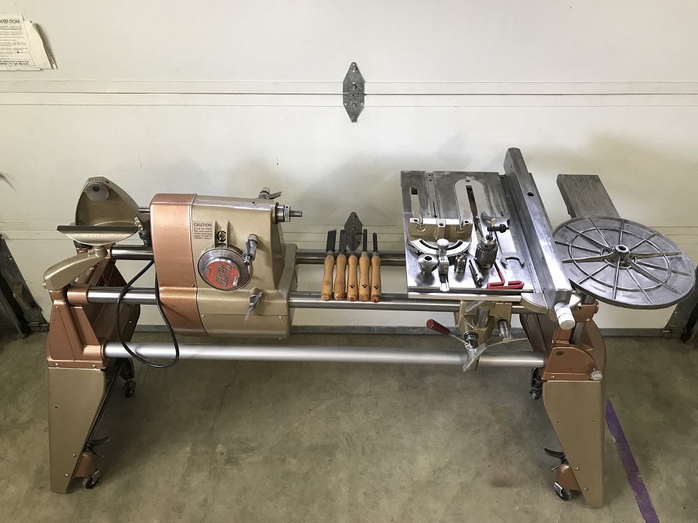

You said it is a "Brownie" which is more commonly known as a "Goldie" with it's Gold and Copper paint scheme. The Goldie paint scheme replaced the "Greenie" paint scheme in 1960 until 1963 when it was changed to the gray color. In 1961 the Gilmer drive was replaced by the Poly V drive. In 1962 the motor was changed from 3/4 HP to 1-1/8 HP. If yours is a "Goldie" than this can narrow down what year yours was made as long as it has not been upgraded in the drive or motor. Attached is a listing of many of the changes to the Mark 5/V through the years.
Mark 5-V Changes over the years.pdf
(81.6 KiB) Downloaded 1390 times
With sales dwindling, after the introduction of the Mark VII in 1963, the Mark 5 went out of production by the end of 1964. The Mark VII was still in production until 1968 when Magna American Corporation ended production on all of the Shopsmith tool line.
If you plan on repainting it the Rust-oleum hammered finish Copper and Oatmeal color paint is a near perfect match. That is the paint used on the restoration below.
IMG_0273 r.jpg (229.86 KiB) Viewed 26332 times
This Goldie made in October of 1960 was upgraded to the 1-1/8 HP motor at some point.
By the way we love seeing pictures.
