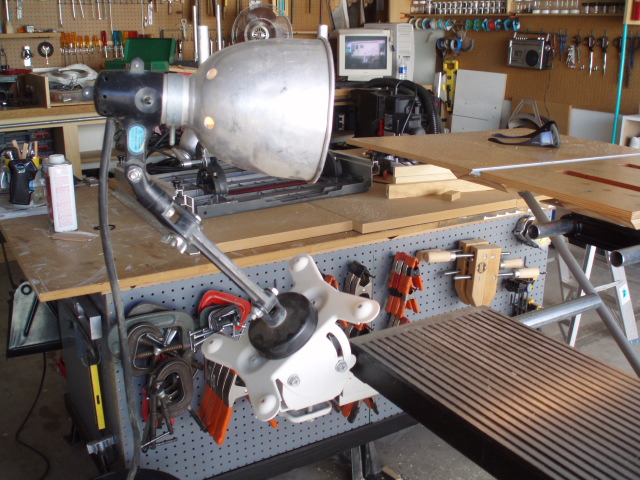

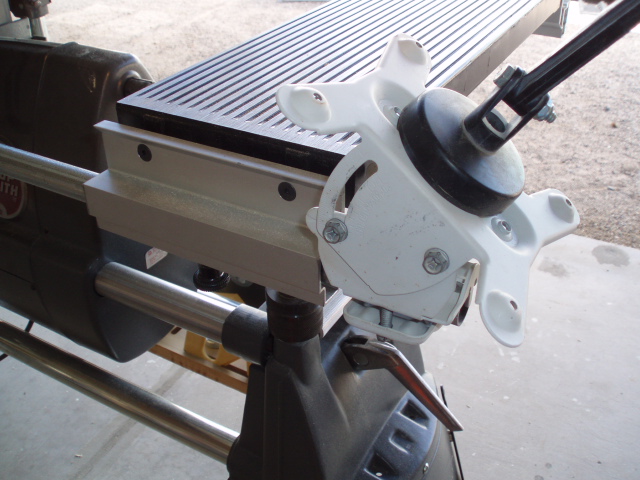

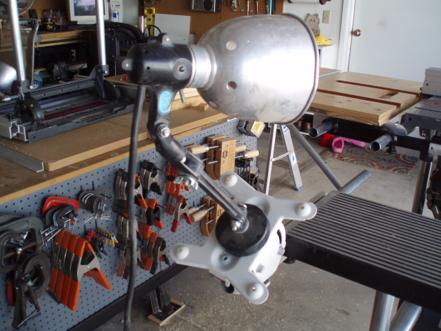

The motor pan and the headstock belt cover are magnetic but I don't see these as appropriate locations for you lamp mount. You won't find many magnetic surfaces anywhere in the Shopsmith gear.
You could drill a couple holes in the side of a table (main, extension or floating) and attach a piece of metal to which you could attach a magnetic light.
Or, you could secure something magnetic into one of the rails and attach your magnetic lamp there. I have a piece of emt with a part slavaged off an old satellite antenna attached. I need to modify this by adding an elbow so the emt sticks straight up rather than out from the Shopsmith.
A metal electrical outlet box is magnetic. You could put that on the end of the emt.
Often, I have these (I have two) attached to my overhead garage door. When the door is open, they are directly over the work bench. Great for after dark. When the door is closed, they shine over my shoulder at the workbench. Shadows are a problem in this position.
