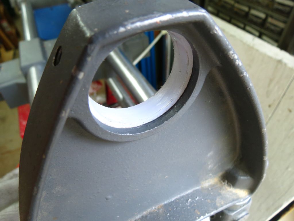

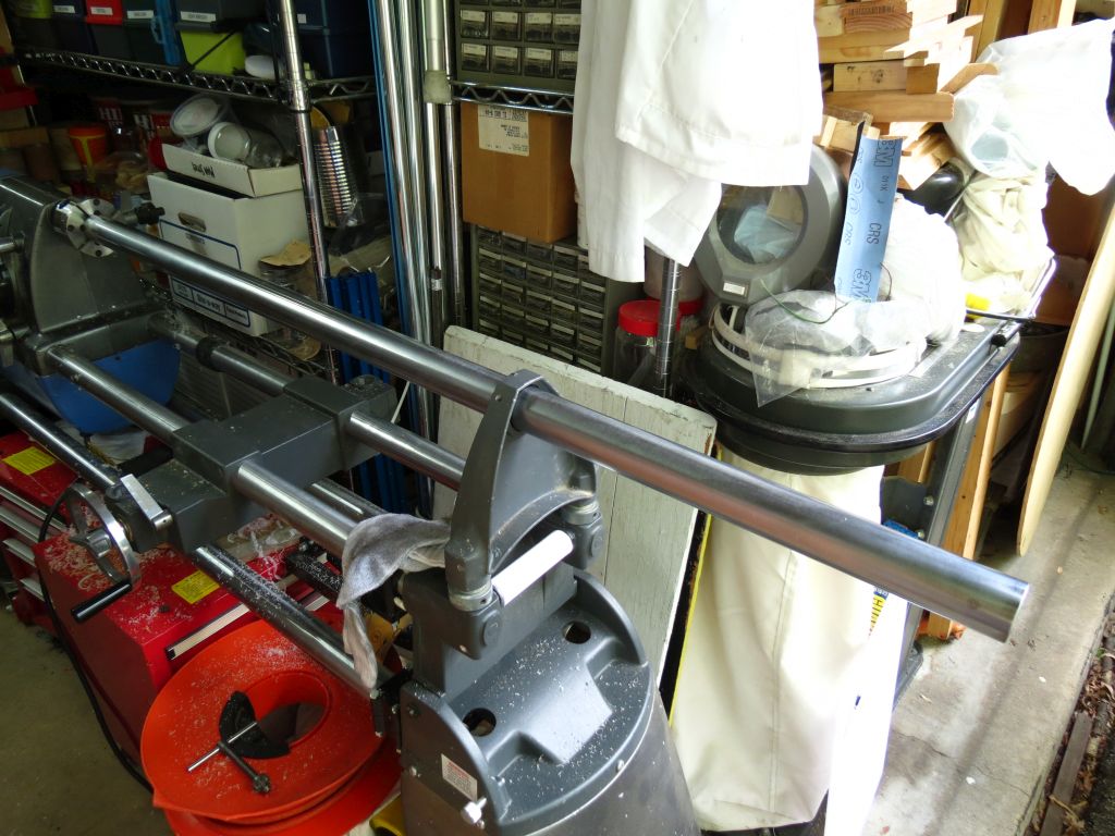

I had a couple more shopsmith tubes coming up to be cleaned so I figured it might be fun to try an idea I had. The idea was to take a piece of the bread boards I get at Sams Club and use the plastic to make a bearing that fits in a tail stock and lets the tubes ride on that while I turned/cleaned them.
In the past I've used a V-block for the tail end and while it worked I felt like trying something different this time around. The set up looks like this:
The plastic insert fits right in and the tube slides in/through. Drilled the hole first then mounted the part on the chuck and turned the out side down until it was a very tight fit in the tail stock.
Did four tubes with it so far. It does leave a small mark on the tubes but hay nothing is perfect. I used some wax on the inside to provide some lubrication but I don't know if really needed it or not. I see no wear yet, not something I do every day so I think it will last me for as long as I need it. Besides it was a fun lathe project.

Might this cause wear in the tailstock over time?

Bearing:jmoore65 wrote:Might this cause wear in the tailstock over time?
Machinery. the support and guide for a rotating, oscillating, or sliding shaft, pivot, or wheel.
The bearing is the wear point. Bearings are replaceable.

If you extend the quill and polish out the witness mark from your bearing, does it make a new mark?

Only if someone is there to see it ....BuckeyeDennis wrote:If you extend the quill and polish out the witness mark from your bearing, does it make a new mark?
My polishing rig with the plywood end does the same thing. I get rid of the witness ring by hand after it has been replaced on the rebuilt machine ....

Of course, but the duration is much shorter so the new mark is greatly diminished.BuckeyeDennis wrote:If you extend the quill and polish out the witness mark from your bearing, does it make a new mark?
Same for rollers etc..
A piece of tape will prevent the second mark.

Thanks Ed ! I have a project coming up where I need some 8 foot tubes and have been contemplating how to polish them.
